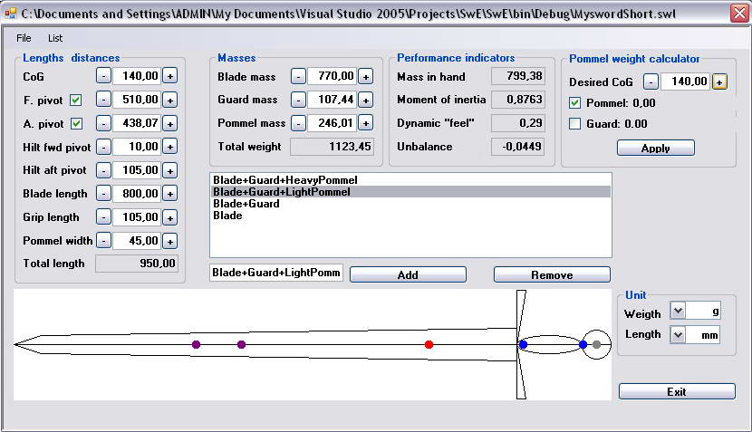

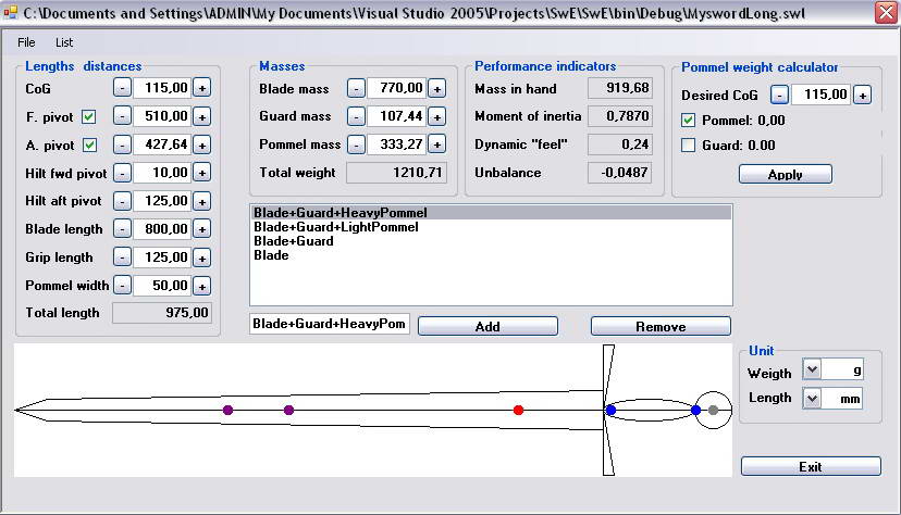

Now I have some dilemmas:
Short (105 mm) or long grip (125 mm)?
Light (240 g) or heavy (330 g) pommel?
Note that I'm 6' 0'' tall and I have a rather large hand, so normal 9-10 cm grips feel quite uncomfortable. A 10,5 cm grip feels fine with hammer grip, but no so great for handshake grip or when aiding with the left hand.
A light pommel looks better and and will lead to a lighter sword of cca. 1100 grams but with a farther CoG (cca 14 cms from guard) with some little variations depending on grip length. A large pommel besides unbalancing the sword will add weight but leads to a better CoG (11,5 - 12 cms from guard).
Following Vincent's instructions I wrote a little program to calculate some basic characteristics and determining pommel weight - CoG variations. I attached some screenshots with different setups.
http://www.postimage.org/image.php?v=Ts5bfxS
Note that the pivots are not yet measured so any characteristics related to them should be ignored.
I will appreciate any advice or opinion so please help!
