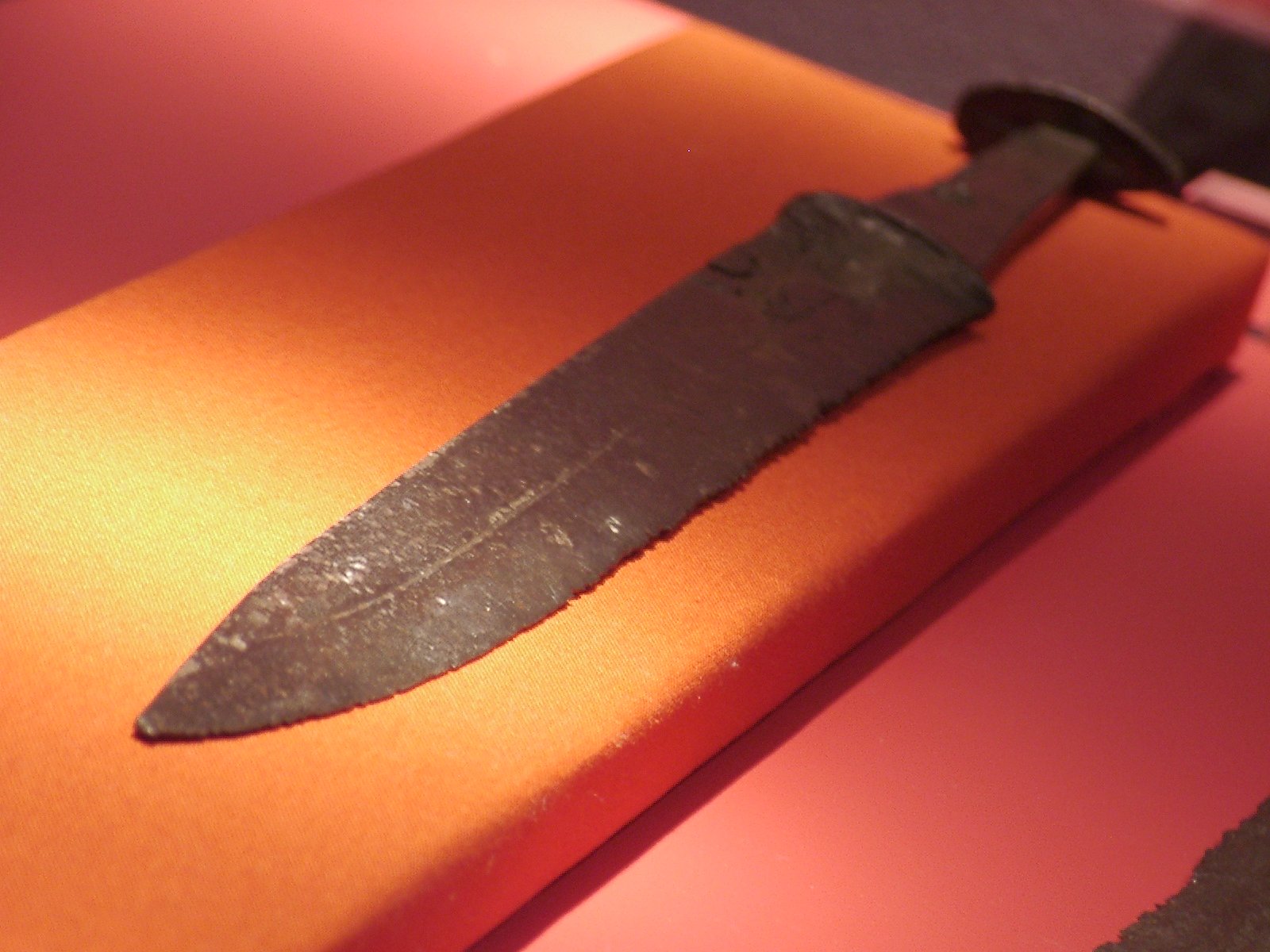

However, I fear that the hilt in your sketch seems to be a bit on the short side. Also, the original seems to have a "scandi-grind" edge profile, rather than the flat or convex profile usual for saxes.
I've attached a top-view of the same sax for comparison. Length is 59cm. And a picture where the grind can be seen. More pictures can be found in Jeroen's "information about saxes" file.
 Attachment: 20.86 KB
 Attachment: 242.46 KB

It is exceedingly rare to see a sax with a defined ground in edge, as in "scandi grind" (I cannot remember seeing one single example). This type of grind is rare on most types of knives in the european tradition before the industrial revolution. It is one of the most commonly made mistakes we see on modern replicas. I guess this is because it is the expected norm on most modern knives.
Cross section on seaxes is almost always triangular with an apple seed sharpening. This is true for narrow seaxes, light broad saxes, broad saxes and lag saxes. Sometimes the apple seed edge is so generous and sturdy that the edge faces are may look like almost parallel, but there is always some taper in the section.
Various types of groves and fullers may decorate these blades. Some set ups are more common with certain types.
Narrow saxes (like the Nijmegen sax in this thread) are pretty slim in shape and proportions. They are more big knives than short swords. Think large japanese tanto. Or perhaps bayonet? They commonly have scraped groves, but only rarely fullers between there groves. You do find decorative engravings on a number of them that originally were inlayed with silver.
Thickness of the back is some 5 millimeters or so, at a width of some 30 millimeters at base. Dimensions would vary according to size. A slightly bigger blade would probably be a tiny bit thicker, while a slimmer example would be thinner.
Point tend to be a not-quite-centered spear point, and the back sometimes has a very slight hint of a clip point form. It can also be a slightly of set spear point made up of two smooth curves. It tends to be rather drawn out. Generally not so much belly in the point.

Yes, but if you look at this attached picture of the tip of the sax, it does look like it's a wide fuller. Indeed rather uncharacteristic...
I´ve seen this sax myself, but I can´t remember this feature...
If it is indeed a wide fuller, then the cross-section would be like a Scandinavian blade, I guess. See the attached drawing.
 Attachment: 47.15 KB
I don't see any signs of a fuller...I do see the two narrow incised grooves i (and Peter) mentioned, though.
Could be, it´s quite hard to see. I think the difference in colour between the edge and the "fuller" might indicate a change in profile (i.e. from convex to fuller), but I'm not sure either.
Next time I visit that museum I´ll try to get a better look at it...

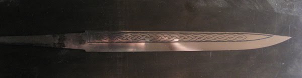

PostPosted: Wed 22 Sep, 2010 1:14 pm    Post subject:         Reply with quote
Here is the last couple of days progress:
I have a little more to do on the blade and then on to the hilt.

Oh, that looks promissing. Big Grin Cool

Awesome! Excellent work on the engravings too!

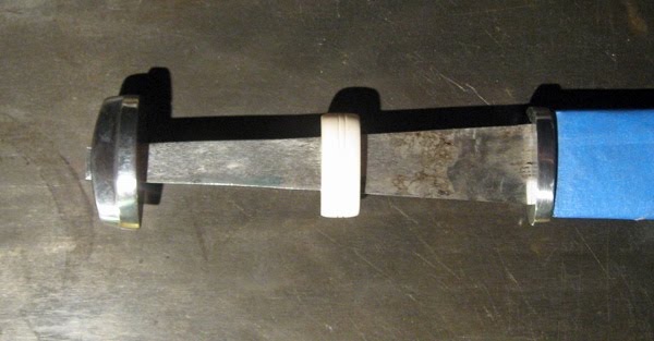

PostPosted: Fri 24 Sep, 2010 7:51 pm    Post subject:         Reply with quote
Shaped and polished the hilt fittings today:

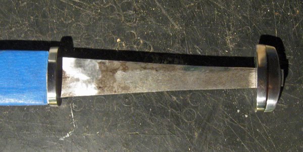

PostPosted: Mon 27 Sep, 2010 8:28 pm    Post subject:         Reply with quote
Here is the day's progress:
Ben Potter Bladesmith

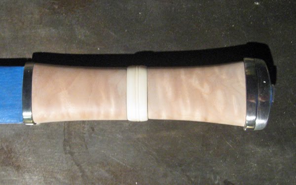

PostPosted: Tue 28 Sep, 2010 6:09 pm    Post subject:         Reply with quote
Here is the hilt as it sits tonight:
Lord willing I will bed the hilt and peen the tang tomorrow and have this one finished.
