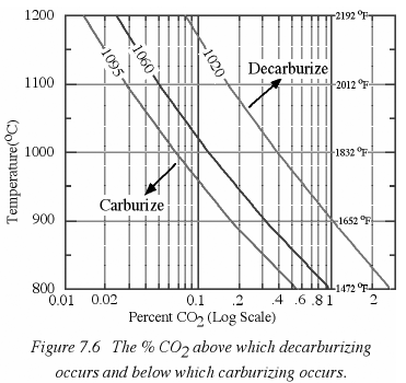

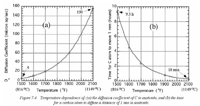

There is some room for debate on gas forges being inferior to coal. Their design and venturi or blower air mix and volume versus openings has some empirical learning required to make them “neutral.” I have a thermocouple and some predetermined settings for gas pressure and choke that seem to work. (I am working straight stock while others are still working on building up their coal fire.) Many of us use flux when going up to welding heat, and accept scale that tends to form before borax melts (around 400, although 25% of total flux mix of orthoborax "roach kill" powder can melt and protect at the lower temperature range where scale starts), and other losses. The trade off is time saved on fire management. If the finished knife hardens close to manufacturer’s heat treat specifications, I figure it turned out o.k. All of that said, I like the coal and hand cranked blower better for forging, and the gas for welding.
I recommend “Metallurgy of Steel for Bladesmiths & Others who Heat Treat and Forge Steel”, by John Verhoeven, 2005. I was able to download it for free. It is technical, but about as readable as could be possible for this kind of material. And, it is pretty much targeted perfectly for the types of participants of this forum who are seriously working at forging and heat treating blades.
Chapter 7 addresses the reducing versus oxidizing environment and some of the chemical equilibrium effects of CO2.
