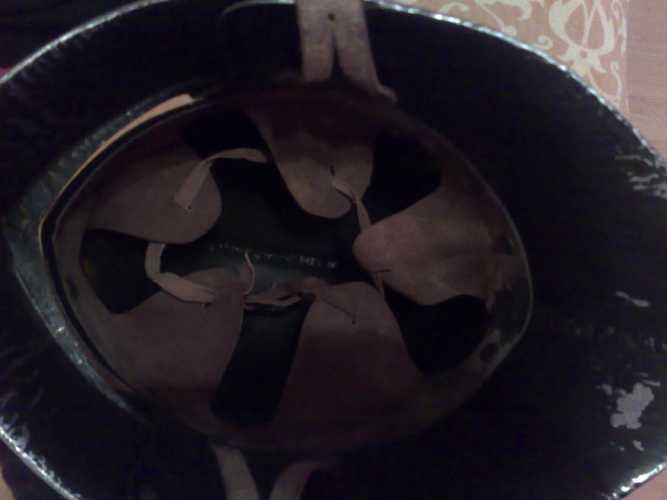

Norbert Keller
Location: Hungary
Joined: 23 Apr 2009
Posts: 44
PostPosted: Fri 12 Mar, 2010 6:01 am    Post subject:         Reply with quote
Hi!
No, it doesn't tilt, it fits closely, there is leather inside my helm, and I have a "very nice looking' arming cap. The brim of my sallet comes down because only this way I can see correctly out from it.
