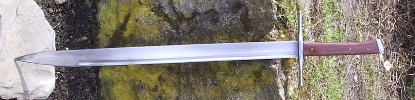

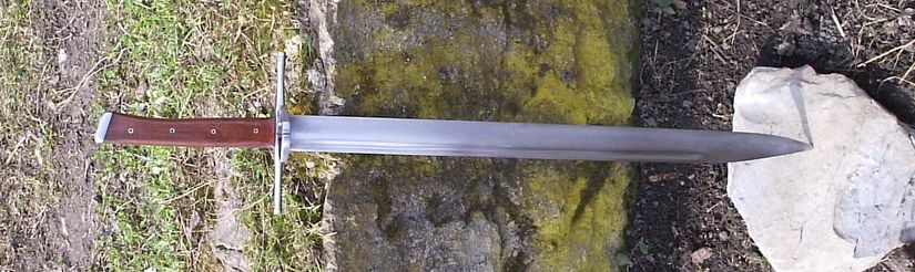

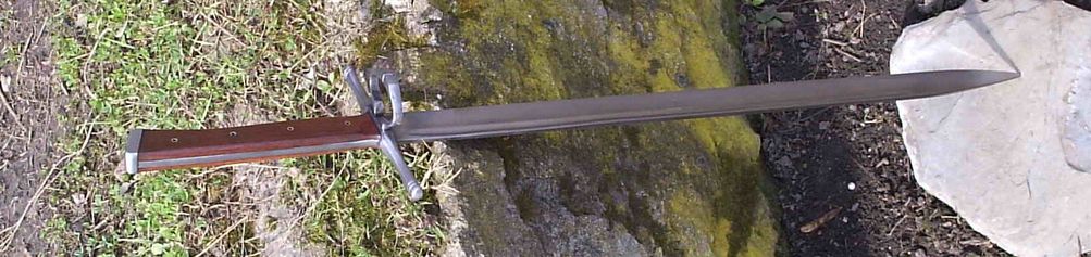

Hello,
I made next messer.
The messer is made from spring steel and hardening 50-52Hrc.
The length of blade is 67cm, width of blade is 4.0cm. The length of handle is 18cm. Weight of messer is 960g.

Wow! That looks great! I like the handle a lot...totally jealous Sad

Stanislav,
very nice. Congratulations.
Is this a blunt trainer as well? What's the POB?

Beautiful, I love the spear-point blade.

Hello,
many thanks.
Hello,
yes, this messer is for training too. The edge is 1.5mm.
the POB is cca 5cm from cross quard

Nice work. I'd be in the market for one if I had the money.
Just out of curiousity, is this a left-handed model, or is the nagel or side ring usually on the inside?

Hello,
many thanks!
This messer is made for left-handed person.

Thank you for the information. Should be a very fast blade with that balance.
Do you make sharp ones, as well?

that's all right ))
I do not made the sharp messer by this time.
