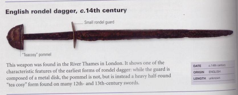

Posted: Sun 21 Aug, 2011 3:54 pm Post subject: |
I recently picked up a book at a bargain book store, I was thumbing through it yesterday and came across this description. Granted that the picture does not give reference to the spine's thickness nor the exact location of the pice photographed, but I took one look at the pummel and noticed the likeness and remembered this post.
Attachment: 45.14 KB
