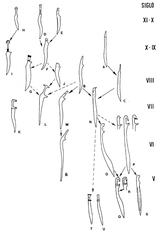

There's absolutely no link between the khopesh and the falcata. The falcata evolved directly from the first bronze single edged knives that came into use in Europe by the urnfield culture. These involved from small knives into large bronze combat knives, and were eventually made from iron, growing larger and more curved. The development is illustrated in this image:
(from this thread: http://www.myArmoury.com/talk/viewtopic.php?t=2729)
N.b. one of these early bronze combat (late bronze age, or early iron age) knives I made recently:
Something worth pointing out is that it's easy to see a link between the falcata and kurki, because both are rather unique looking shapes. But similar blade shapes have evolved repeatly in many other examples. That doesn't mean there is an evolutionary link. Well, there may be a link, but the shape can have changed to something entirely different before getting to the same shape again first. A good example is the bronze age rapier and the real rapier. In a way they are evolutionary linked, but swords have gone to many different shapes before getting back to a similar geometry.

Jeroen,
Thanks for that chart of blade evolution, it was very helpful! That is a very nice dagger you made, I really like that look.

Kostas, I think that was one of the best expositions of a theory I have ever seen on this forum! Cool
A couple of points occurred to me though: Is there any more evidence than just the depictions on stelae to suggest the form of hoplite tactics as depicted was derived form the Greeks and is not simply an indigenous form that appears like hoplite warfare? For example northern European shield-wall tactics appear to mirror hoplite warfare in many respects, but I don't think this suggests that the ancient Germans derived it from the Greeks. I'm not saying your wrong in this idea (in fact the theory seems pretty plausible to me), its just that theres only so many ways of using a spear and shield and just because one thing looks like another it doesn't necessarily follow that the two are connected.
The second point is a bit more general. Earlier on in the thread someone commented that the Greek Kopis was derived form the Iberian Falcata and that this developed from from weapons brought to Spain by traders before Greek civilisation developed. As far as I was aware didn't this happen the other way round, i.e. the Falcata was an evolution from the Kopis and that it was inroduced by Greek colonists?
