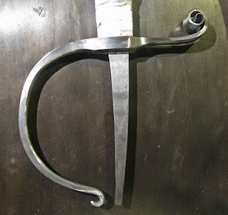

Here are the steps so far.

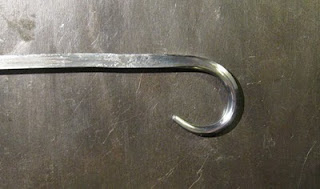

Knuckle bow and thumb-ring after forging:
Thumb-ring after shaping and polishing:
Knuckle-bow in-let for the tang, and rough shaped:

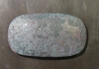

I finished shaping the knuckle bow and forged the shell guard:

Whats the shell forged from? Is it wrought or something?
Matthew Stagmer
Youtube.com/ThatWorks
Ben Potter
Location: Western Idaho
Joined: 29 Sep 2008
Posts: 347
PostPosted: Thu 14 Jan, 2010 9:59 am    Post subject:         Reply with quote
1018 mild steel, wrought it really hard to get on this side of the country, I'm looking for it but it is elusive.
Also, I thought that the steel would work better for this design,

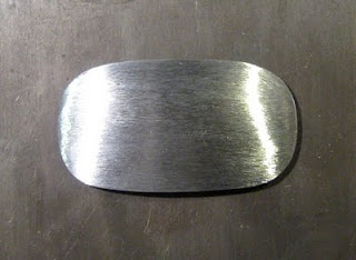

Made it back to the shop today for a bit and shaped the shell guard.
I bought about 100 lbs of wrought from these folks. Seems to be good stuff, though it took me a couple tries finding the right heat to forge it at (you have to forge it *very* hot -- almost at white heat -- or it crumbles and splits ). I got it in 12" long sections of the 3/4" round and 1/4" x 2" flat. We are relatively local to each other...Let me know, and I'll let you have a piece, at cost, to try out.
The wrought is from an old (late 1800's, i believe?) grain elevator.
http://www.wisconsinwoodchuck.net/price_list_wrought_iron.pdf
