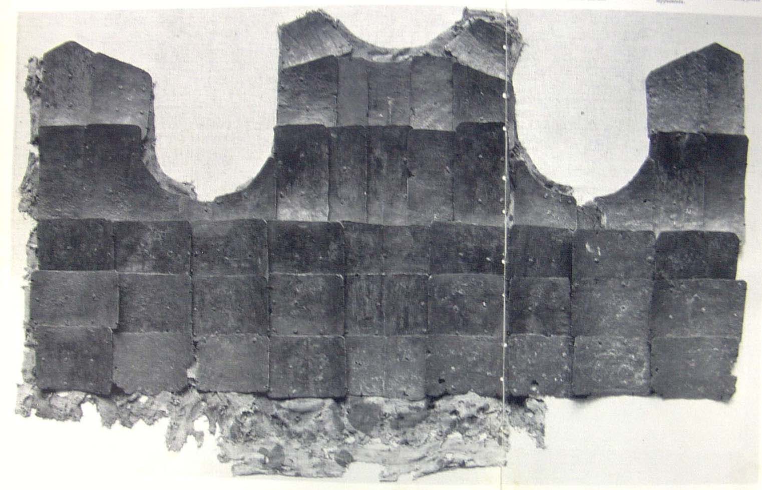

Here is a picture of the brigandine/coat of plates, taken from Armi e Atmature Lombarde.
As we can see, the reconstruction posted by Igor has ignored some of the evidence.
It is clear from the ragged fabric and old rivet holes on the left, that there used to be more plates on at least that edge.
I think, that, in spite of what appears to be a "negative crest line" down the center, this armor is best interpreted as a back opening defense. Adding the missing plates along the opening line would serve to make the back broader than the breast (as it must be), and make the neck opening less "pinched". So much the more so if we assume that there are plates missing from the right edge as well.
The overlap direction of the plates also supports the idea of a back opening.
Also, if we assume back opening, the additional armored length is now serving to cover the lower abdomen; and that’s all to the good as well.
I wish I could explain the negative crest line in what would then be the front.
Doug, have you looked at this piece in person? Does the crest really go that way, or could this be a photographic artifact?
Mac
 Attachment: 133.74 KB

Doug Strong
Location: Chicago, IL (Suburbs)
Joined: 16 Dec 2004
Posts: 49
PostPosted: Wed 23 Apr, 2008 7:00 pm    Post subject:         Reply with quote
It is possible that is is a photographic artifact. I have not handled it myself. The photos in Boccia certainly look like a ridge.
Perhaps we should arrange a time when we can go see it together.
Now that I look at the layout more closely I agree, it is probably back opening.

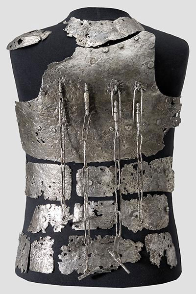

The above caot of plates posted by robert look similar to the square lower plates in this coat of plates found in Burg Hirschstein Passau castle 1350 even though the plates are rather degraded.
 Attachment: 68.18 KB

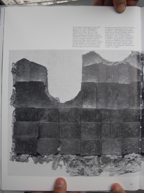

PostPosted: Sun 21 Nov, 2010 3:37 pm    Post subject:         Reply with quote
Armi e Armature Lombarde, Lionello G. Boccia, Francesco Rossi and Marco Morin. p. 50
here the page.
 Attachment: 121.89 KB
That's an intriguing COP, Jared - do you know where it is published? I did some searches and couldn't find any references.
Neil Melville
Location: Scotland
Joined: 27 Oct 2009
Posts: 219
PostPosted: Fri 25 Mar, 2011 10:34 am    Post subject:         Reply with quote
Hi Jamie
that coat-of-plates from Hirschstein castle was illustrated in Hermann Historica's auction catalogue of 'Alte Waffen', no.52, May 2007, lot no. 3641, with detailed photos and description in German and English. It is also illustrated in an article 'Mail to Plate', part 2, in the GB magazine 'Classic Arms and Militaria', published November 2010.
Neil
N Melville
