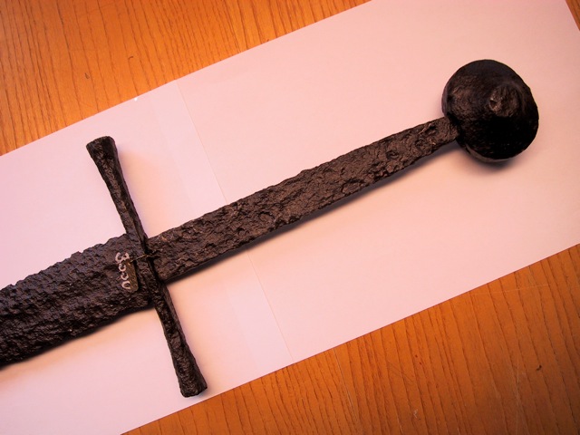

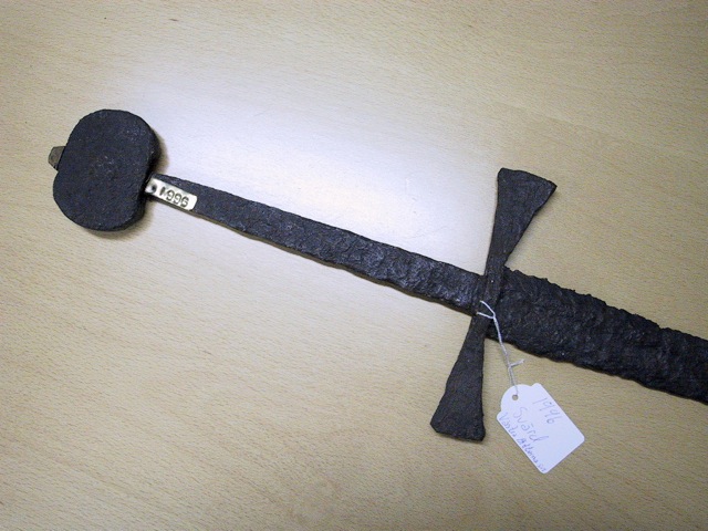

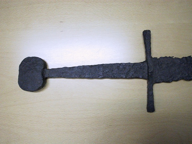

I called the museum today and they gave me permision to post the pictures here! As you can see the grips are maybe not as long as on some of the swords earlier in the thread but they are still a lot longer than usual hand and a half swords. I don't know anything about them at all since I accidentally found the box they were in while looking for other things. They are still ying in the same order as I found them. One of the swords hava a more "normal" grip. Next time I'm at the archives I'll dig further into their swords and see if I can find more...
What do you think about age of the swords below? My guess is from late 13th century to mid/late 14th century.
Anyways, premission to post these images comes from Gotlands Museum, Fornsalen here in Visby, Sweden.
Bigger picture here: http://farm3.static.flickr.com/2778/4295198358_a7a89ca52f_o.jpg
Bigger picture here: http://farm5.static.flickr.com/4029/4294454447_1c20eaac12_o.jpg
Bigger picture here: http://farm3.static.flickr.com/2679/4294454475_fd74f4a070_o.jpg
Bigger picture here: http://farm3.static.flickr.com/2763/4294454507_b0819b6fce_o.jpg
Bigger picture here: http://farm5.static.flickr.com/4013/4295198454_f7eb03f569_o.jpg

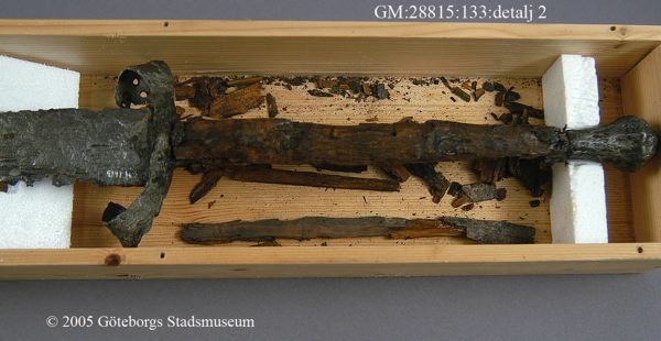

How could I forget theese from Göteborgs Stadsmuseum, Sweden? The first two are about the same type as most before. The third however have the quite unusual "pretzel" shaped quillon.
More info here: http://carlotta.gotlib.goteborg.se/pls/carlot...idn=101077
Length: 129 cm, blade 97 cm, grip 32 cm
More info here: http://carlotta.gotlib.goteborg.se/pls/carlot...idn=430994
More info: http://carlotta.gotlib.goteborg.se/pls/carlot...sidn=38291
