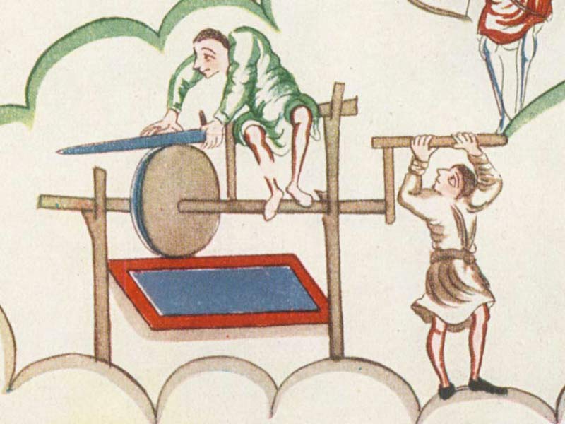

This image is circa 1150 showing a sword being ground. It's from the Canterbury Psalter:
Below are two illustrations drawn from period art as found in Knives and Scabbards -- a publication from the Museum of London.
