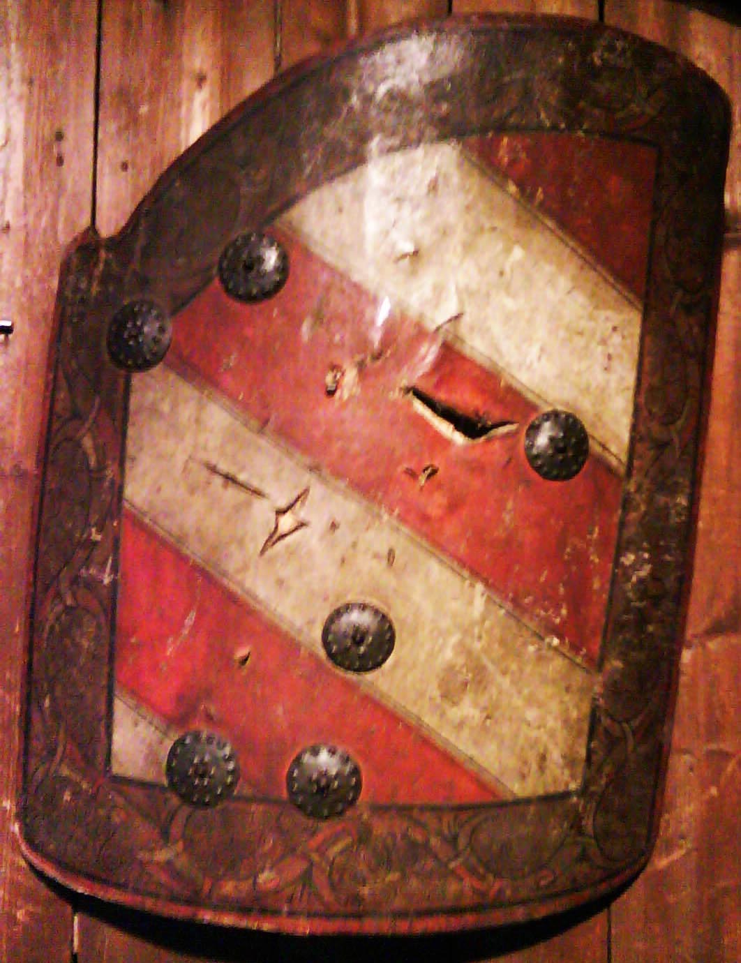

PostPosted: Sun 13 Jun, 2010 4:22 am    Post subject:         Reply with quote
Greetings, gentlemen!
I think that the previously mentioned winged shield is a hungarian one, since such paintjob could be observed in other examples too, like on the one in the attachment. This is a Hungarian hussar's shield from the XVIth century, kept in the Arsenal of Graz. The rivets and plates indicates the place where straps were attached to the back of the shield. This confused me, so I asked the curator about the arrangement of them. He stated that the two rivets in the front holds the grip, the two in the back holds the arm-strap, and the bottom two formed a little holder for a secondary weapon, so if the soldier lost his sword, he could have caused a surprise for his opponent, by quickly pulling out a dagger or similar weapon from the shelter of the shield. Tricky? Dishonorable? Well, a French traveller in the XVIth century wrote that he would rather trust a Turkish than a Hungarian.
But what I said was true! Wink Laughing Out Loud
 Attachment: 185.76 KB
Hussar's shield from the XVIth century. Graz, Arsenal. Sorry for the poor quality [ Download ]

PostPosted: Sun 13 Jun, 2010 10:56 am    Post subject:         Reply with quote
This is very interesting and valuable information, although it may be a little bit tricky.
Thanks, Janos!
Today I cut the shield blank (I will show pictures of the process in my next post) and made some research on arrangement of the straps and usefulness of this type of shield in infantry combat.
As I suspected before, the shield is quite useful as infantry equipment also, offering a good protection for the torso and, especially, the head and the neck.
What was really tricky (that's why I started this post with the phrase "it may be a little bit tricky") was the fact these advantages come to life if only the holding straps were arrange in the way, mentioned by Janos - alongside the short diagonal of the shield.
If the straps were placed alongside the long diagonal - from the "horn" to the opposite corner (a displacement, which I supposed was common and good for cavalry), the shield became cumbersome and heavy, and offered far less protection than in the previous case.

PostPosted: Sun 13 Jun, 2010 11:49 am    Post subject:         Reply with quote
The shield posted by János Sibinger is a different style of wingshield, this one looks like it was designed for infantry, the straps are mounted in a different manner and the "tip" of the "wing" is much lower. The shield is also smaller than the previous posted versions. This type of shield has a tricky problem. You need to place very carefully the straps or the shield will become unbalanced and the "tip" of the "wing" (i.e. the upper right part as you look at the front of the shield ) will tend to act as a lever when you will try and block a blow, making very hard to controll the shield when the blow is comming downwards from the left (i.e. from the users point of vue). In the begining of our reenactment group we have made two shields of this type and we haven' t enough experience with strap setting then, so both of hem are unbalanced and unpleasant to use.

PostPosted: Sun 13 Jun, 2010 9:59 pm    Post subject:         Reply with quote
Greetings!
Romolus, good points there, and altough I have never used such shield I still would say that this was a shield for cavalrymen. You might have noticed the little notch on the edge of the shield, near the shorter side. That is somekind of lance rest, at least we could observe such usage of this little notch in the Chronicon pictum (a well decorated Hungarian manuscript written by Márk Káltay. A nice source if you are interest ed in the XIVth century.) Furthermore I haven't seen any shields in the museums of my county, presenting the ottoman period, neither winged, nor rounded ones, only Turkish, yet multiple breastplates, helmets and alike is being presented, in good condition. Yes, this might be becouse of the shields were made of materials wich could easily get rotten and damaged, but I think that if they were common phenomenon on the battlefield we would have somekind of trace at least, but I am yet to meet with it (of course I haven't seen all of the museums and I haven't been into the warehouses. Yet... Wink

PostPosted: Sun 13 Jun, 2010 10:34 pm    Post subject:         Reply with quote
Yes, but it could also be a handgonne rest as seen in the following picture from (Codex Manuscript 3062, Austrian National Library, Vienna) - source: http://homepages.tig.com.au/~dispater/handgonnes.htm
Then the shield would have been an infantry shield Happy ...
