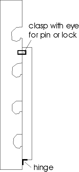

With a horizontal wall rack of the style sold for Japanese swords, where the vertical pieces are planks with cutouts for the swords, all you'd need would be to put something in front. Hinge at the bottom, some kind of latch at the top. If the top latch is high enough, you don't need a lock there. The piece in front could be clear plastic. If there is a wall on the hilt side stopping the sword from being pulled out sideways, it would be secure enough to stop quick removal.

 Attachment: 1.31 KB
Simple sword rack clamp
Thanks. That's a good design. I think I can mount such a rack where it would be impossible to pull the swords out sideways. Some of my walls have sort-of "pillars" at the corners, where the pillar sticks out 15cm from the wall. If I mount it near there it would not be possible to pull he swords out, provided I don't make the rack deeper than 15cm.
