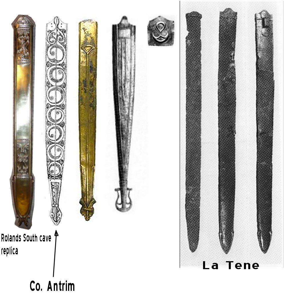

PostPosted: Thu 31 Dec, 2009 7:38 am    Post subject: South Cave sword         Reply with quote
Hi All,
I recently was fortunate enough to be invited along With Roland for the hand over of this particular sword at Beverley, so can I say a big thanks to Roland for letting me tag along (and a big thanks to Dave Huggins for arranging this). The sword is truly a treasure and beautifully made. It feels comfortable in the hand and is balanced excellently. As a budding sword smith myself I can safely say this sword is pure 'porn' for the enthusiast!
Now to my second point,
to Peter Johnsson, not meaning to sound pedantic, I'm merely being devils advocate here, as I truly respect your work and obviously acknowledge your knowledge on the subject.
However with reference to your comment about the fitting, being for the lower hilt guard as opposed to the mouth for the scabbard, may I note my disagreement. Roland and I did discuss this at the museum and I cited several examples where the convex decorative mouth on these various celtic 'Iron Age' scabbards quite clearly is part of the scabbard and is obviously designed to 'mate' up with the corresponding concave shape of the bottom of the lower guard.
I have attached a pic illustrating this.
I don't mean to stir up a hornets nest, but this, I feel is an interesting question, and one which many may be curious about.
In my opinion the fitting is most definately part of the scabbard, despite Rolands misgivings (Sorry Roll!)
So can Peter, Roland, or indeed anyone else solve this riddle?
It would of course be nice to inspect the original to see if indeed it was in fact 'Fitted' to the scabbard.
Bruce
 Attachment: 161.44 KB

Further to Bruce's remarks concerning the the convex shape of the scabard, I had also previously discussed this with Roland,and during that conversation recalled to him that I had seen other similair reconstructed scabbards by a French artisan.
Please take a look here for further examples of reconsruction.
