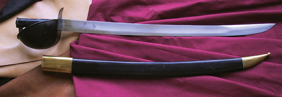

Aren't these just the usual Indian-made replicas that have been on sale for years, with the fake Klingenthal marks and anchor on the blade. Windlass used to make them, amongst others. You can pick them up for around $75 on the continent:
http://www.armae.com/contemporain/14xixxxsieclecadre.htm
(about halfway down the 'sabres & epees' section)
Julian

I see two noticeable differences between what I've bought and, the replica on the page. The grip on the link is nearly in line with the blade, whereas the one I own has a noticeable drop downward. Also, the tongue-like protrusion that comes out of the back of the hilt and, rises up a bit toward the back of the blade has smooth edges in the photo, while mine has a rounded serration-like design.

It weighs in at 2 lbs, 13.5 ounces. The width at the back of the blade is about 5/16 or 6/16 thick. It tapers gradually down to18.75 inches of the length, where it's about 1/8" wide, then tapers drastically maybe to 1/32" wide, 1 inch to the end of the point. Hope that makes sense.
The top of the cup is about 2/16" thick, but the hand guard is thinner. It's tough to accurately measure because the sides are flared outward.
"I see two noticeable differences between what I've bought and, the replica on the page. The grip on the link is nearly in line with the blade, whereas the one I own has a noticeable drop downward. Also, the tongue-like protrusion that comes out of the back of the hilt and, rises up a bit toward the back of the blade has smooth edges in the photo, while mine has a rounded serration-like design."
Mike, the differences are because I posted an 1833 pattern, yours is the earlier 1801 pattern. You'll find both on the replica market, but just because it says Klingenthal on the spine of the blade doesn't mean it was made there......(the factory there closed in 1962 - as far as I am aware, the only factory in France still making swords is Chevalier d'Auvergne).
That's not to say that it (and it's Indian cousins) are not good swords. However, some of the really low priced replicas are not heat treated or tempered (they just grind them out of mild steel), so caveat emptor. It sounds like you have a good one.
Julian

Thanks. They don't say where it's made. How would one tell if the blade wasn't heat treated? Would it bend and, stay bent, or does heat treating provide flex and, return to the blade? How is the quality of the swords from the site you posted that photo from? Many of their swords look like those on military heritage.
You'll know if a sword hasn't been properly heat treated because it will take a set if you bend it just a few inches out of true (ie. it will kink). Lots of the cheaper Indian and Chinese made swords (some advertised as 'battle-ready' or 'made from EN45' etc.) simply aren't treated (or very poorly treated at best). It's not such an issue if it's semi sharp and built like a crowbar, because most customers are never likely to use it, just hang it on a wall or parade around with it in costume!
There are not a million versions of these types of 'Napoleonic' era swords. They all come from India, from a couple of makers. The similarities between Military Heritage and Armae (and a dozen other retailers in Europe and the States) is simply because they are all peddling the same products.
As mentioned above, the only factory making Napoleonic swords in Europe is Chevalier d'Auvergne. Their products are not cheap, but the quality of their blades is excellent, although they have their own quirks, too. (please note, I used the term 'factory' - there are many independent makers in Europe who will make you Napoleonic era swords).
