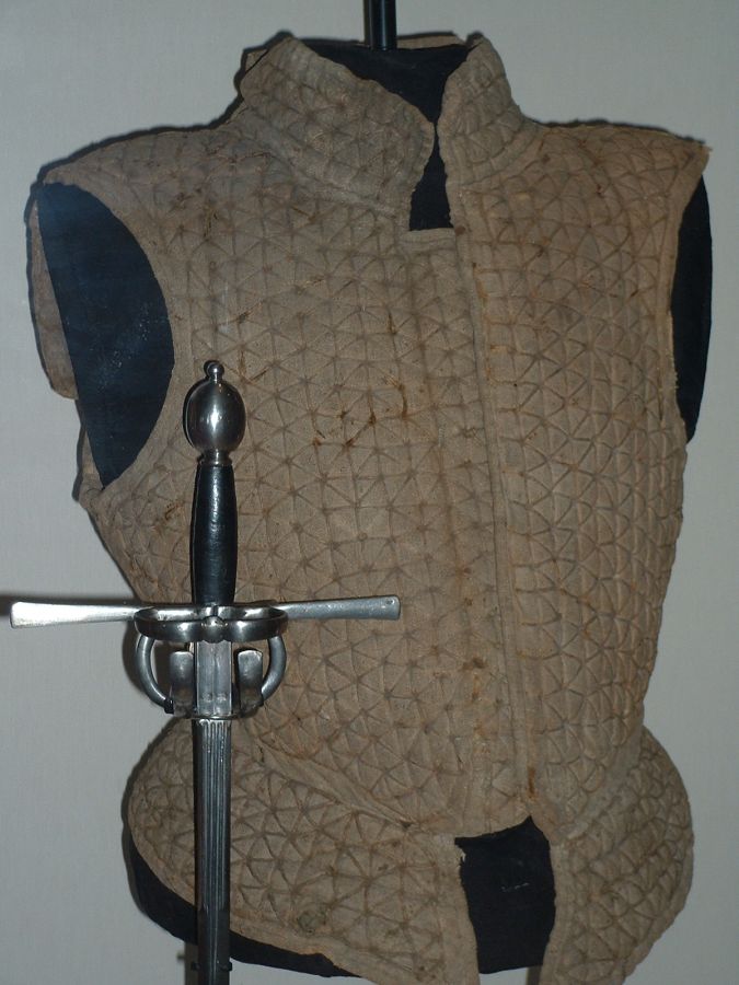

I'd love do a padded jack based off the one in the scottish national museum, just up the road for me... I've been doing my best to resist making a replica of that one for a few years now, on grounds that I want it, but would be of limited use for me... it keeps going "make me!" every time I visit, and I've been itching to misuse the restoration notes I got hold of last year. However, as that'd be a bit too commercial, I'll bite my lip and merely dream.
but for the dagger, I can help you, and say it's more likely to be a dudgeon dagger at that point in time. Ballock knives were out of fashion by about half a century by then, and rondels a lot more still....
and a pic of the jack in the scottish national museum, for you to "ooh" at, if you're anything like me...
