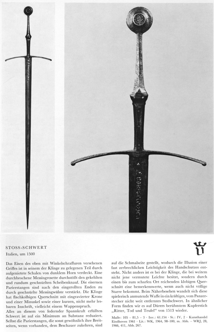

Thrust-Sword, Italian - circa 1500
My inspiration this time comes from a child's bastard sword wth an overall length of 105 cm.
She is so beautiful and unique that I could not resist not making it.
All info was obtained by scrutinizing the picture and following the description in the german text.
Needless to say that I had to enlarge the sword by about 25% and somewhat keping the proportions.
So, here she is;
Overall length :------------------- 53 3/4 inches
Blade length :--------------------- 40.1/2
Handle length :------------------- 10 1/2
Blade width at cross :----------- 1 5/8
Blade thickness at cross :----- 0.250
Center of gravity :---------------- 4 1/4 from cross
Center of percussion :---------- 24
Blade steel :----------------------- 5160
Weight :----------------------------- 3 lb 15.9 oz
The handle is made of Amboyna Burl and Ebony. Metal work on the cross, handle and pommel is of brass (see text on picture), oxidized to tone down color and shine. Rivets are only decorative to preserve strength.
The tang is peened, permanent, final - to prevent me from fooling around with it.
Enjoy.
Gabriel

The twisted wires are laid over and under the crossed guard as shortly mentioned in the german text and evident in the picture. A short glance may not reveal this easily, but I'm sure it's there? As for historical examples of this feature, I can only think of the Count of Leonhard von Goerz's sword, which I am presently working on and will be posting here shortly (hopefully), other than that I rather not speculate or guess, This is something left to the members here who are better versed in history and historic swords.
I chose to insert samorodok in the pommel because the text talks about a brass (scrollwork) rosette? of some kind and the picture being not very clear, I chose not to do any guesswork.
With a blade type XVII this is a larger sword then the Munich, but with a COG at 4 1/4" and a stiff blade she handles like a charm even single handed.

There is a twisted brass wire mentioned and shown in the original picture, supposedly to strengthen the ends of the cross guard. The way I have done is not necessarily how it was in reality, consider it an artistic and aesthetic representation of what it may have been.
