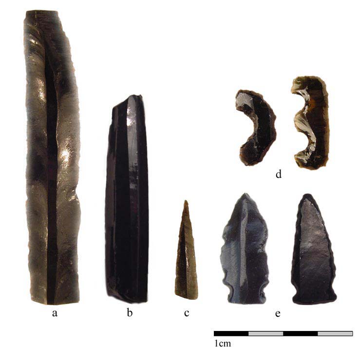

Prismatic blades have parallel edges and are trapazoidal in cross section. Although sometimes they will be trianglular if the flake runs across to one of the previous ridge lines. The core will have a flat top and the blades will flake off the sides of the core and run the length of it. Here are some examples that I found online showing examples of prismatic blades and cores.
For anyone interested, Jim's youtube videos are interesting to watch. This is his first one on blades and cores, and it shows some of the ones that he has made, talks about how he does it, and shows museum stuff that he has taken pictures. It is just the first of a series

I'm not entirely knowledgable about flintknapping or their terms, but I believe "prismatic" refers to the process by which the blades are made. Instead of taking a piece of obsidian or whatever and flaking pieces off to bring it to shape and refine the edges, prismatic blades are flaked off a conical core of material. You go around the circumference of the core, knapping off these long, relatively straight blades. What results are blades with flat backs and usually a ridge on the front side from previous blades being flaked off of the core. They come off the core perfectly sharp, with no need for edge refinement.
