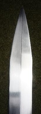

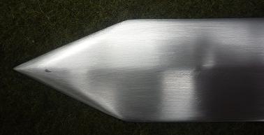

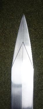

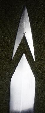

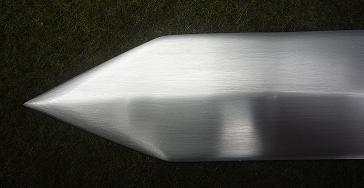

For the first installment of this project, I have been reshaping the tip of this sword. The original tip is just a little too pointy to be a classic Pompei Gladii. I removed a large portion of the tip using a Dremel cutting tool. I took things very slowly, making 3 or 4 passes then dabbing with a damp towel. This never allowed the blade to get hot, thus ruining the temper. After about 1.5 hours of cutting this is the result...
 Attachment: 31.34 KB
 Attachment: 27.49 KB
 Attachment: 31.2 KB
 Attachment: 28.91 KB

Looks like a good start Luke !
I keep wandering why people dont just make the tips the right shape in the first place - its hardly the most complex sword blade in the world ever .....
Have a good look around the net at real gladii hilts, a fair few good pics out there & dont make the grip too long, should only just fit the hand ie nice & tight grip with the pommel & cross bolcks.
Keep up the good work Happy

Well, it seems that your application of my suggestion to use a dremel with cutting wheels was very successfully accomplished. Big Grin Cool A lot lest frustrating than trying to hacksaw hardened steel or" slowly " wear things down with files/stones.
When you do a neat job of it like you seem to have done you have a lot less of work to do than if you had to take a lot of material away the hard way and a lot less work using stones to rebevel and sharpen the point ! Big Grin

Yeah sorry about that illustration. I didn't intend for it to seem as though that was what it would end up as, but rather just to better explain how I will get extra tang if I need it. I was under the impression that the shoulder area was not at a right angle but it was just a quickie illustration.
Good idea Jean with the holes drilled, and I have a center punch so I should be able to get the drill where I want it. Also something to illustrate your other point about the cutting wheel being round. If you notice the cuts made on the removed part of the tip you notice I had to go past a little to get to where I wanted. Cutting to the hole will eliminate that. So when i rework the tang I will be make the shoulder more then 90degrees and I will round out the corners to minimize weakness in this inherently weak area.

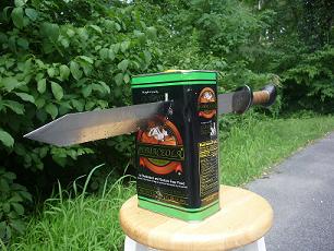

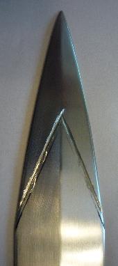

Here are the pictures of the tip, and the tip in action. I did not get the geometry perfect, but the blade will still be serviceable. If you notice the tip leans a little bit to the one side. Oh well it is my first try. Tip test and both sides othe the blade... Enjoy!
 Attachment: 42.96 KB
 Attachment: 28.13 KB
 Attachment: 27.57 KB

The point looks great! Don't worry, most original blades are lopsided or asymmetrical in some way. Worked fine anyway.

PostPosted: Mon 10 Aug, 2009 12:13 am    Post subject:         Reply with quote
Luke - Well done. Did you hand hold that wildcat (dremel)?
Luke Zechman
Joined: 18 Jan 2009
Posts: 278
PostPosted: Mon 10 Aug, 2009 6:51 am    Post subject:         Reply with quote
Yeah I did it by hand. I actually used the cutting wheel to make like a dashed line on the sharpie line I had drawn. This meant holding very steady and touching it to the surface on the line. Then I touched down on the spaces between the dashes, until it was a complete line. Once the cut line was complete and deep enough it was there pretty easy to stay in groove. Like keeping water in a trough.
PostPosted: Mon 10 Aug, 2009 7:37 am    Post subject:         Reply with quote
Good for you! It's liberating to start hacking up one of these things. You start to realize the possibilities!
PostPosted: Mon 10 Aug, 2009 7:51 am    Post subject:         Reply with quote
Yup that sounds like a good way to do it and I never thought of doing it this way: I would have " hoped " for a steady hand on that first critical establishing pass with the cutting wheel. A bad establishing cut is hard to recover from as the cutting wheel stays in the groove but at the same time if it's a good establishing cut holding the dremel steady in subsequent passes much easier.
