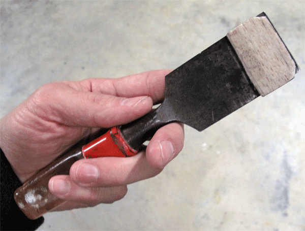

If you are willing to share, could you post a pict of you custom swivel knife?

Thanks! I meant to get a shot of my chisel setup and forgot to do it. I'll get that ASAP and post. I thought folks might appreciate that trick Big Grin

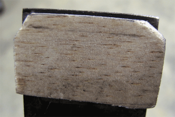

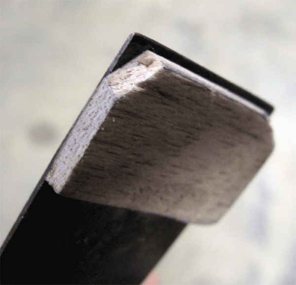

Here's the chisel I rigged for the leatherwork on the chappe. All you really need is a thin strip of wood. I used this piece as I found it just because it was the right thickness (about .25"). I clipped the corners so I could more easily see the ends of the blade--those have to be placed precisely so they don't stray into the horizontal band at the bottom of the chappe.

ah nice technique on the chisel - thanks for sharing that tip! I like how your project is turning out. nicely done all around. you really have gotten the chappe making down. looks good.

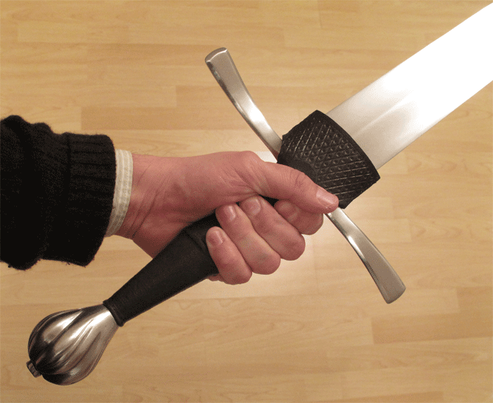

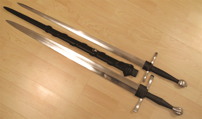

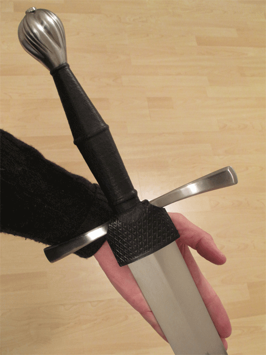

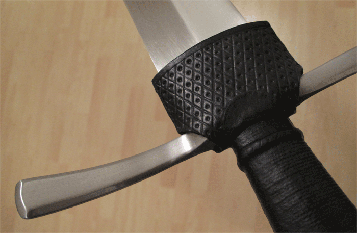

The sword is finished but for some minor finish work on the peen block. Here are a few quick shots. I'll get a proper series of photos after I finish the scabbard and suspension--maybe another week or two. You can see the difference between my last Type XVIII project--a riding sword--and this war sword. Similar length and style, but very different in the hand. Both feel right for the blade type. This broad blade feels very authoritative but well-balanced.

that is some brilliant work Sean!
I am green with artistic jealousy. I keep meaning to try my hand at some sword modifications, but then I realize that I don't have the equipment to re-peen the hilt, I get too nervous about bending a cross, etc.
It's great to see your work so I can get the itch to try it again for myself.

Thanks! Peening scares me too. I'm still figuring it out, and I wonder if Windlass swords are not the best blades to learn with. Their tangs seem to be pretty hard. But you'd be surprised how easy it is to recurve a cross like this. All you need is a propane torch, hammer and $30 anvil from Harbor Freight. The detail work takes much longer--little files, mostly.

The way you turned that 'cheap' sword in a much more elaborate and beautiful one is just outstanding, Sean. I really like your improvments. Congratulations !

Sean, unledd you got very girly hands that seems to be a quite massive blade! Very nice job though. It's nice to see the chapes you make, they look really nice. Gives an extra touch to the whole impression of the sword.

Yeah, it's a big sword. Not especially long, but very broad. The hollow grinding makes it feel lighter than it looks. I haven't weighed it yet, but it'll certainly be over 3 lbs.
