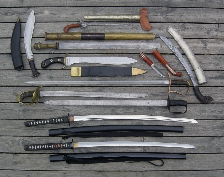

Attachment: 143.02 KB
My collection, including two Hafström blades. Third from the top we have the army's fascine knife m/1848, and fifth is one of the Stockholm sabers. [ Download ]

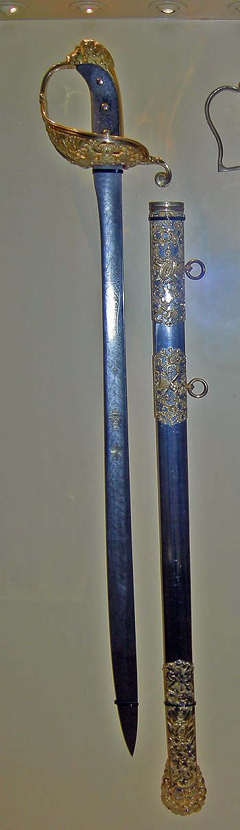

Attachment: 71.35 KB
Saber carried by general S. Lagerberg, 1860's. On display in the Army Museum in Stockholm. [ Download ]
