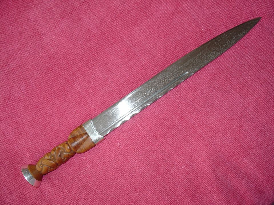

Together with the Reeve, I also tested my own creation (a Scottish dirk). This little monster cuts through a water bottle like it's butter. It is sharp.....quite sharp. But does this make the difference?
I'll include a picture of my work. I's the second knife I have made. I started with a sgian dhu.
On this one I altered an existing blade. I added a full tang and slightly altered the tip.
For the rest of the design, I have been reading this website.....
