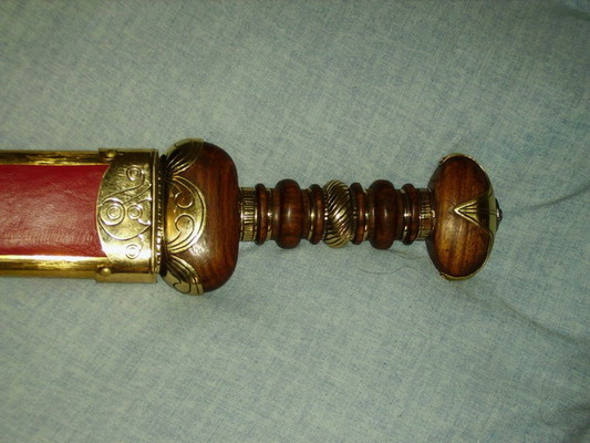

The Hilt:
Let me first say that this is an absolutely beautiful sword. The pictures on the website do not do it justice, nor is any picture that I could take (forgive my shoddy photo work). The hilt may seem a bit small, and it is, but this is fully consistent with actual Roman era hilts (and I believe that this is an exacting replica of the original Hod Hill sword, and so it's dimensions mirror that). The hilt is peened.

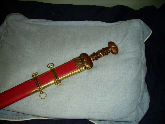

Scabbard Serendipity:
The scabbard included is definitely Roman in style, with a bit of British/Celtic flavor at the mouth (there were plans to produce an optional all-metal Celtic-style scabbard, but I don't know anything else about that). It is a beautiful scabbard, well-made, with great stitching in back and a perfect fit for the sword. I'd say this is one of the best scabbards I've ever seen on an India-made sword (Deepeeka's Roman scabbards included). And, you know what, I've always had such great luck with Deepeeka's scabbards -- they always seem to fit other swords in my collection. So a couple of my older Albions and my Erik Stevenson gladius hispaniensis are sitting in Deepeeka scabbards now. So moved, I tried this scabbard with my Albion early spatha -- and it fits pretty darn well. Just a bit loose, but otherwise fine. Serendipity? Maybe!

Just my opinion, but be very wary of this sword. Mine came in from the UK yesterday. The pommel is crooked, the blade is canted to one side and sits noticeably closer to one end of the guard than the other. I'll try to post some photos, but a personal email with bring photos if I have trouble posting. I have to admit that I wasn't expecting much and knew it would be very blade heavy, but was hoping for at least a good display piece.
Since it too poor to display, I will try to improve the finish on the blade, then maybe grind the peened end off and see what happens.
Please don’t invest your money in this item.

Good Afternoon.
Well since I listed the problems I had with the sword, it is only fair to update the situation. It turns out that I was sent a rather crude prototype in error. After some exchange of photos they agreed to take it back, (They are in the UK) even though I had started repairs. They sent me a replacement which is much nicer, and have even offered to repay me the shipping charges.
All through this they have been first class in their attempts to solve this problem and seem very nice people to deal with. They are a small company and as such are able to give personal attention. I would not have any problem in ordering anything from them.
