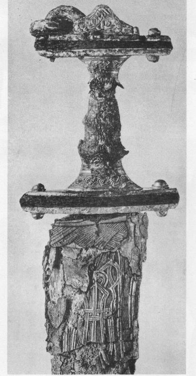

In the rich boat-graves of the Valsgarde/Vendell numerous swords were recovered, of those, Valsgarde 8 grave is of particcular interest to me because it containes the famous/infamous "stave armour" parts that have been interpreted in numerous ways over the time. Anyways, I wanted to ask if anyone have done any research in the details of construction of the scabbard remains that were discovered within the grave or perharps made a reconstruction of one? It is clear from the descriptions that it had a wodden core and leather facing, also from the pictures it appears that the part near the hilt of the blade was covered with bronze/latten deccorative plate.

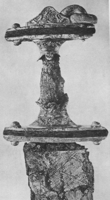

Here is one bigger photo. Unfortunately I don't know anything more than you wrote already, because I don't speak German. :(
I would like to make this sword (or generally one of Vendel/Valsgarde swords)one day one day for myself, but now I am too busy with others projects.
Hope this will help a bit.

Thank you for the photo - it does show decoration on the scabbard quite clearly, but, sadly does not provide other answers. I do not own the exact replica of the sword in question but rather a blade that is made in style quite similar to this one, albeit without the ring. And as part of updating my combat gear to be more precise representation of the Valsgarde 8 grave finds, so I am working in the scabbard along the way of working in the helmet itself - which is a rather interesting project by itself.

Regardless, back on subject, here is a rough translation of the description of the Valsgarde 8 scabbard from Arwidsson's book:
"Immediately by the hilt some fragments of the sword scabbard were preserved. The scabbard consisted of 5/64" thick wood strips that were covered on the exterior with thin leather. Perhaps the interior had a similar lining, presumably of a hairy pelt; namely, several small, hard to interpret fragments indicate a hide with furry structure on the interior. Below the mouth the scabbard was wrapped with a very fine, double bound cloth, and thereon sat an artificial band woven out of bark strips. The original width of the cloth and of the bark band cannot be determined with certainty, yet probably they had not entirely covered the preserved part of the scabbard. The bark band be permitted sooner than anywhere else dem bei den scabbard of the Vendel Period usual mouth fitting have accord with and be likely approximately just as wide as these gewesen sein. Yet this embellishment of the scabbard could not have been original, on the contrary the cloth and bark band must have originated from a later repair. On one side of the scabbard they cover a carved wood animal motif, plate 20, that without doubt in the beginning must have been completely visible. The fine leather covering of the wood strips must have been pressed in such manner over this carved decoration, that the pattern stood out on the leather. Es handelt sich also um a style of leather carving, fur die es mehrere, gave better preserved examples from other sword scabbards from Valsgärde (see Valsgärde 6 and 7).
Any traces of metal fittings were not observable on the scabbard, not even a fixture for the sword suspension strap."

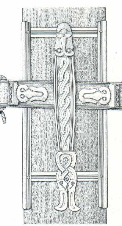

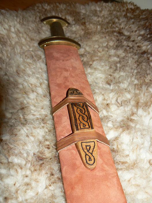

Well, here it is - my attempt at the Valsgarde 8 scabbard. Wodden core used as base, I carved design similar to the original on it's surface, then glued thin leather over it all. Designs on the part used for attachemnt of suspension system is based on the similar part from Valsgarde 7 sword 1 scabbard, although on that one it is made of metal.
 Attachment: 67.51 KB
Original suspension system attachment part from Valsgarde 7 sword 1 scabbard.

Scabbard and blade.
