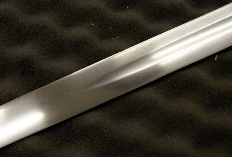

The Type XII got a new pommel which drastically changed the way this sword handles for the better. I was oringinally going to have a rounded surface leading to the raised facet but it felt so good when I tested it prior to rounding the face that I left it flat. It feels a lot more like business in the hand and the blade is much more responsive. Here is the link to the old thread:
http://www.myArmoury.com/talk/viewtopic.php?p...ht=#150101
Overall: 36 7/8”
Blade: 31 1/8”
2” round fuller length: 19”
Width at guard: 2”
Width 2” from tip: 7/8”
Weight: 2lb 4 oz.
CoP: 19 1/2” from guard
Balancing Point: 4 3/4” from guard
$725 plus shipping

Love the double fullers and complex grind on the second sword a lot.
