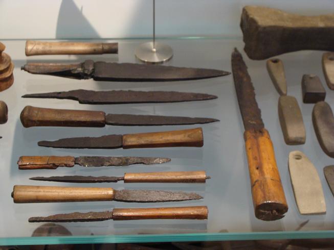

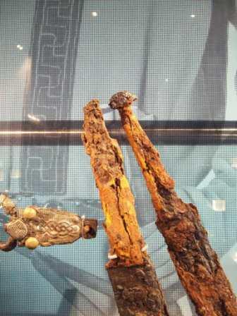

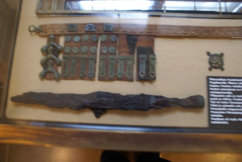

Hi I have loads of pics of originals... The problem with most replicas is they don't look very accurate the hilts were rather plain by modern standards and merchants must make what sells. To many people want them to be all carved and leather covered etc. There are thousands of antique seaxs (I have one in my private collection), during the viking era knives were like a symbol of being a free man and everyone caried them, rich and poor alike, many were made by local smiths and are of dubious quality. The hilt will really depend on the size and type of seax, seaxs range from 3inch little utility knives to lang-saxes the size of a sword. On a few of the quite large ones there are rivets but your statement is very true you don't see rivet holes. Most originals which had a "wittle tang" had simple carved wood hilts, a few of which have survived....
I will post one pic now but I will have many which I can post later.
 Attachment: 47.05 KB
Salve Hadrian!
Wow, yes please, most helpful to me (and all true seax fans out there)! You wrote you wanted to use antler on your seax. That was what I was planning, too, as well as some yew core wood. The left handle in the picture you posted also looks to be bone or antler. I would be most pleased if you could post what pictures you have of both bone/antler and wooden handles. You could also send them to my e-mail acount, that has a 10 mb buffer per each mail with a 5 Gb overall limit.
I have made glue using pine ressin mixed with a bit of bonding agent such as charcoal (could use "sacred" yellow ocher as well) and some fat. When heated, it works very well to set things solid. I suppose the bone glue one can buy as pellets and then heat to 100 C should also work very well, that is what I intend to use on the seax. Basicly the same as the glue you made, which is also a bone glue if boiled out of antler scraps. I have used it to set points on my neolithic throwing spears (for an atlatl). I quit chucking flint points, though, (not a very adapt flint knapper, prefer a coal fired forge) but the trials were fun and man, does an atlatl pack a punch!
Hadrian, I too would be most pleased to see any images you have, particularly sax handles, as so few have survived. Can you give us any information on the ones in the image you've posted?
Robert: wood, bone, horn, and ivory seem to have been the more common materials used for grips...whatever was available locally that made a good handle seems to be what was used. The construction is hidden stub-tang, with only adhesive and wedges to hold the knife together in most cases. Metal fittings, judging from the surviving artifacts, were rare in the extreme after 700AD or so, and are generally only found on continental style type I blades, or the full-sized Norwegian single-edged swords. Some surviving grips appear to have traces of wire wraps.

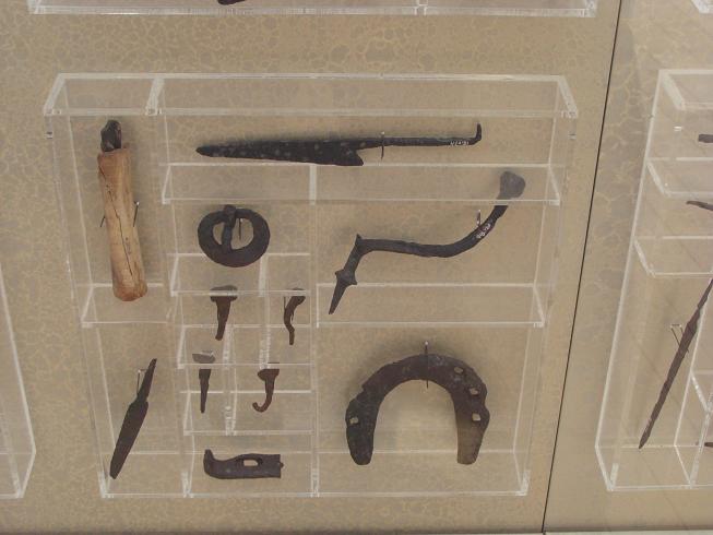

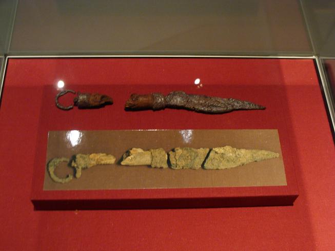

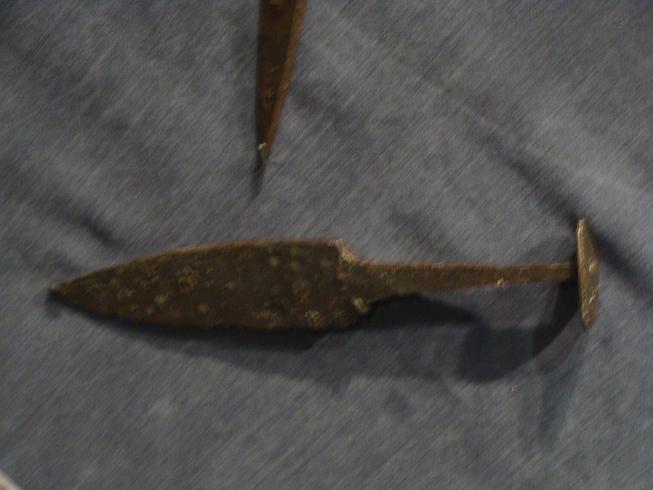

Hi here are some more pictures as promised. On the previous one the left hand one is bone the one on the right is carved wood in a shape reminiscent of antler tine (tip) the right hand one is interesting as the tang slot is drilled through the curve with an opening at each end, the knife the hilt belonged to curved with the handle and was peened at the end.
Another interesting way I secure knife handles to wittle tangs is to melt pewter and pour it into the slot in the handle when it hardnes it creates an amazingly powerful bond, the historic evidence for this is scarce there are several knives and seaxes with globs of what looks like melted metal corroded onto the tang. It is not necisarilly historical but it is certianly historially plausible. another benefit of the metal glue is that it ads weight and balance nicely to the hilt.

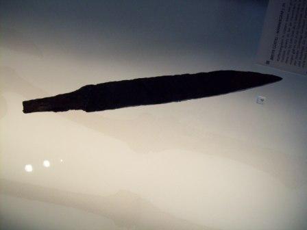

any way here are the pics...

odd pommeled seax

Those are great pics, it is really helpful to see the original hilts. Is it just my imagination, or are there a couple of those blades that have metal bolsters too?

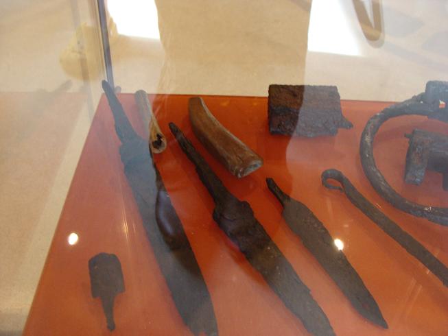

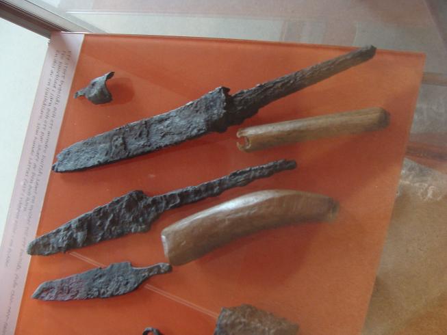

These pictures are wonderfull!! To show my gratitude, I drove to the new Xanten museum in Germany to add a few pictures to the collection:
As an afterthought, the seax in the picture is about 58 cm with a 18 cm wooden handle. What remains of the sheath looks to have been wood as well, perhaps an inner wooden core. The blade is decorated with grooves and small punched circles, but this can't be seen in the picture now due to loss of quality compressing it. These are finds from 1 grave, there is also a small utilityknife with a wooden handle hanging from the belt to the right.

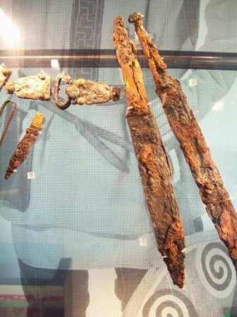

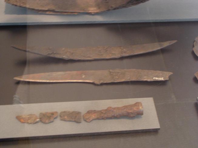

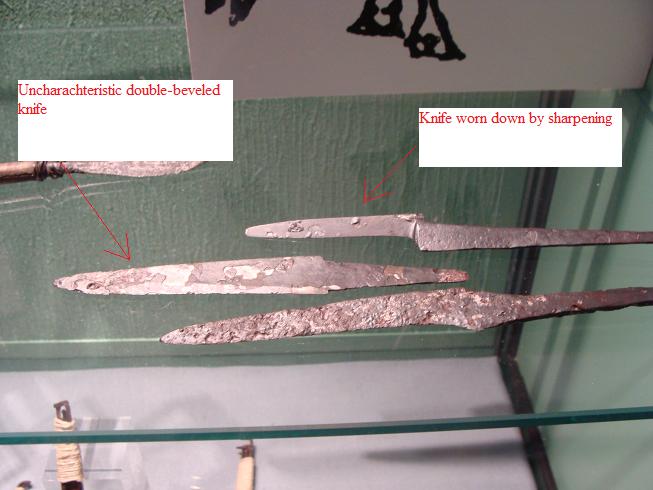

Hi Hadrian. Unfortunately most of these are either Roman or iron age, and therefore not saxes (at least by modern archeology). There's actually quite a lot of examples of saxes with hilts preserved. Particular the better preserved examples from graves frequently have remains of the hilt attached. Unfortunately though, it's generally just bits that are closest to the tang that have been preserved, with the outer part of the hilt decayed away. So from that, and the size of the tang it gives an indication of the minimum measurements of the hilt, but not the actual shape and decoration. However, there is evidence that shows more. However, you have to restrict yourself to specific types of saxes, as the hilt evolved along with the blade. Early narrow saxes f.e., seem to have had fairly short hilts (by sax standards). A well preserved example can be seen below:
These saxes are from Krefeld-Gellep, Germany and date to around 5th-6th century (estimated).
Later narrow saxes, and the following light broad saxes frequently have metal components in the hilts. The hilts also grow longer, with grips of around 15cm.

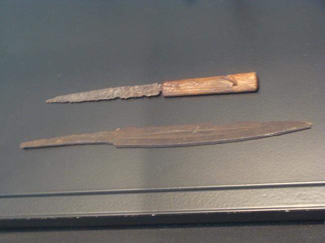

I am adding a picture of a 7th cent sax in Xanten. At 35 cm overall, this would class as a light droppoint broadsax of around 630 AD (typology)?? And these would typicly not have metal fittings to the hilt? With a 25 to 50 centimeter blade?
Broken back saxes are not shown in the typology, are these only found in Britain?

There's quite a bit of variation on size. Broad saxes can vary from 25 to 50 cm blade length, and 3 to 6 cm blade width, and the thickness anywhere between 4 and 10 mm.
Generally the earlier ones are smaller, the later ones larger, but there is some overlap. Langsaxes in the Netherlands have a pretty narrow size range, with the blade generally around 50-60 cm long, 40 to 48 mm wide and 5 to 9 mm thick. Other countries have longer examples as well though.
That should be about right.
Some early light broadsaxes do have either a metal bolster or bolster and pommel. But the majority don't have them. With heavy broadsaxes there are virtually no examples with metal hilt parts.
No, they're also found at least in the Netherlands and Germany, though not quite as common as in the UK. With broken back saxes you have to keep in mind that there are basically two different broken back saxes, the long sax variant with parallel edges (Hurbuck type), similar to the curved back longsaxes but with a sharp angled back, and the smaller broken back saxes, which have the back and edge expanding from the hilt (Honey Lane type).
