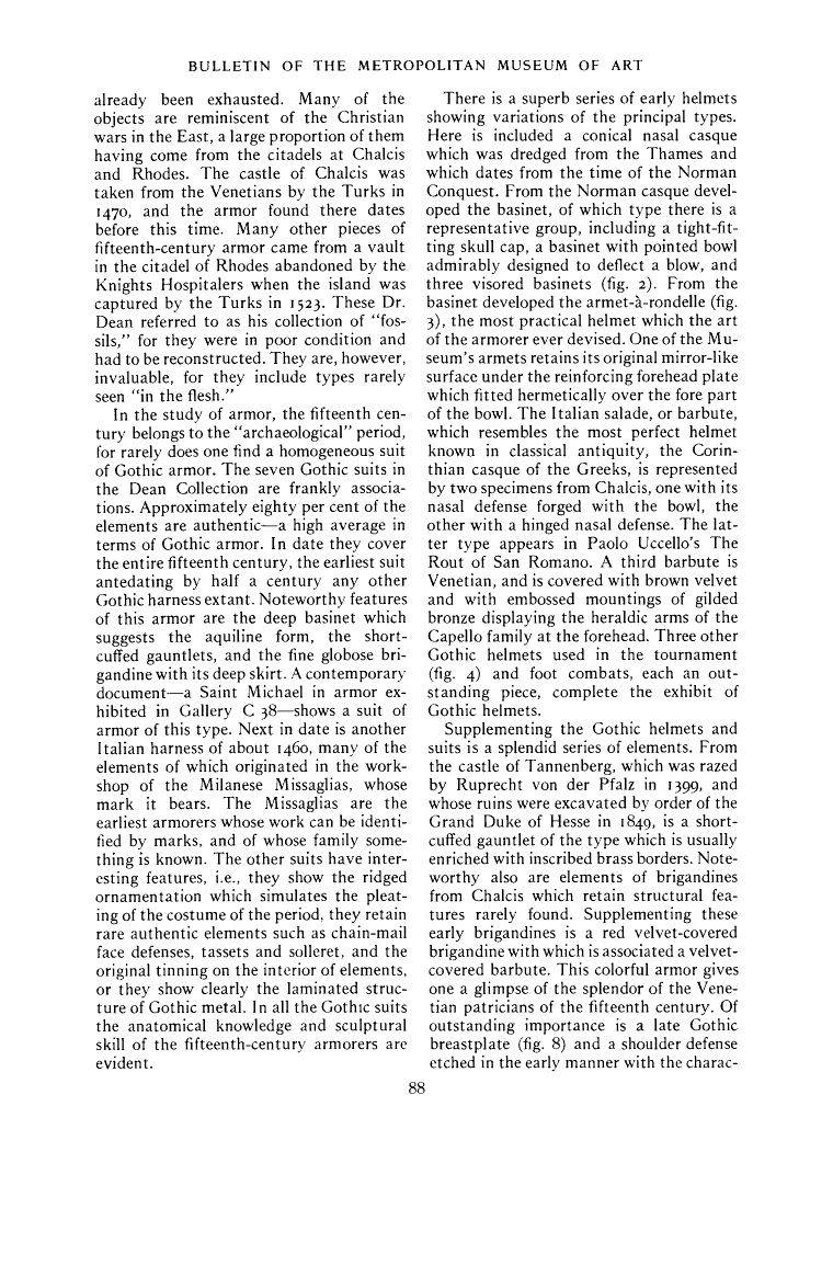

HI Will, where did you find the reference to the Norman helm with hinged nasal?
Here is the page from that article that references the helms...and it appears clear that it is referring to two separate helms....one a Norman nasal....and the other a barbute with hinged nasal.
However, I would be interested in hearing of any findings of conicals with hinged nasals.
Hope this helps,
Dan

Dan Dickinson
Location: Michigan
Joined: 03 Oct 2004
Posts: 967
PostPosted: Sat 22 Nov, 2008 7:23 am    Post subject:         Reply with quote
Hi Will,
Unfortunately those"..." in google are the problem.
The page I posted is the one from the full article and the "... "in google are that parts that show that it's not a conical with a hinged nasal, but rather two different references.
Dan
