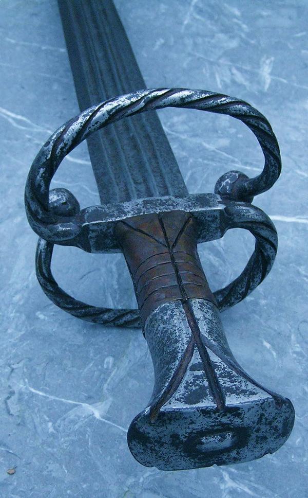

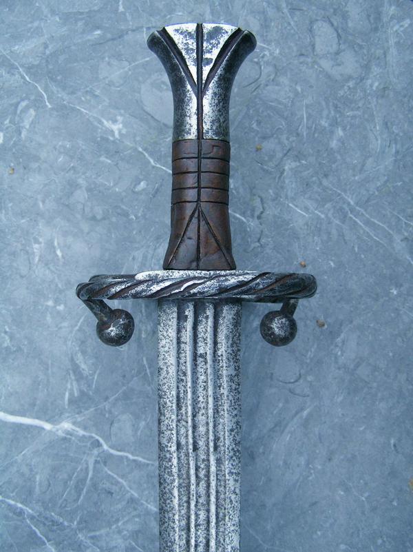

Greetings everyone! I recently acquired this Katzbalger sword. It was heavily corroded so I had it restored by a professional archaeologist. The wooden handle has been replaced. Several experts have looked at the sword and some say it's an early 16th century original, others say it's a Victorian copy. What do you think?
Here are some pictures of the sword:
 Attachment: 45.45 KB
 Attachment: 31.71 KB
 Attachment: 48.42 KB
 Attachment: 77.09 KB
 Attachment: 92.75 KB

To me it looks victorian or most probably even more recent manufacture. To venture a guess, I would say it is about 3-5 years old at most.

IMHO, I fear Peter maybe on to something here. The pommel in particular is almost certainly very modern. The guard could have a bit of a victorian flair but it has a massive quality that one usually only sees in modern reproductions. Even the Victorians when they went heavy did it with a bit more flair. The blade looks a touch better than the rest, though two thing about it catch my eye. The fullers seem to have a strange flow down the blade and the tip is a bit of a cliche for Katz blades.
The last thing is the corrosion seems to be very surface orientated. The black areas seem to be sitting on top of the material. I would expect to seem some deeper pitting and aggression around the edges.

Looks a bit like this sword from a known Czech maker. Aged and with a new grip of course. Blade with three fullers, three groove pommel. The pommel is a little different but these are made by hand and that could just be a result of different production runs. Cross guard is nearly identical and not just for the type but on a sword-to-sword comparison.

Thanks for your post. I really don't think it is that recent. It was heavily corroded and cleaned by a professional archaeologist who was sure the corrosion was certainly old. And the experts who have seen it in hand were sure it was an old sword.

Yes, it looks similar to that one, but mine is definitely handforged and this looks more like machine work (on the blade/fullers). Probably the Czech maker based his copy on an original.

I've contacted the Czech maker through e-mail and he told me he did not make my sword. He said my sword is certainly all forged by hand and old, and he uses machinery to make them. His swords are based on early 16th century examples.

Rust is not so difficult to produce.
I did a project for fun once, to make a practical joke on a friend who worked at the Historical Museum in Stockholm. I showed him a broken sword "that I just bought in an antique shop during the Medieval Festival in Visby, and could he please say what he thought about it".
Of course I had made the sword just the other week.
He did me the compliment to be envious for at least a minute or so. And then we got a good laugh together when I told him the true story.
Old iron, acid and humid storage will turn new work into rusty remains in very short order. Much of what we see on the internet sold as genuine antiques looks like it could have been made only a few weeks ago.
To tell the genuine from the fakes, I think you have to look at shapes rather than rust.
I am no chemist, however and I could not tell if rust was ancient or newly made based on analysis. From just looking it is hard to tell.
The pommel on that Katzbalger looks like it was made first on a lathe and then ground flat on its faces. Then cut or chiselled. I would not be surprised if the lines were cut with some sort of grinding tool. Perhaps some forging was involved in the shaping (like flattening a turned trumpet shape, there by increasing the flare and flattening the faces), but a tell tale thing is otherwise the obvious forging marks on the guard. They do look a bit coarse, especially as the shape of the guard is easier to shape neatly with the hammer, than that flaring pommel which has a very smooth "waist" or outline in contrast to its rather crudely cut groves. To me eye at least it does not add up.
Another note worthy thing is if the fullers do look forged. These groves were as a rule ground rather than forged. Rather shallow and often not so distinct. In contemporary replicas fullers are often left a bit rough as antiques do hint at this look after centuries of patina. When they were new they would have been neater, even though a bit wobbly at times.

Thank you for the pictures before it was cleaned. I am afraid this only makes it look a bit more like a modern piece as the corrosion is very red and looks like it is dusty. (the rust comes off in a smooth dust when rubbed)
I think Ian has found your source. If you send a pic of your sword to them my bet is they will tell you when they made it. The details seem to be even more modern when you see the tang that is under the grip.
Another telling factor, is the pommel solid? If so it favors the modern date. Often these style of sword had hollow pommels in period.

The pommel is hollow, not solid. The tang goes into the hollow pommel and there is room enough left for a part of the wooden grip that went also into the pommel (that's what an antique sword dealer told me it was for).

It would be interesting to see this hollow.
Could you please photograph that angle, so the base and hollow of the pommel is clear?
Another note on the fullers:
Notice how the first 10-12 cm of the fullers run parallel, and then there is a kink, or slight misalignment?
This matches pretty exactly the sword from Kowex Ars shown above: same type of traces from the tool.
I would not be surprised if these two blades were forged with the exactly same tools. Probably in a press or power hammer.
This kink, or un-eveness tells you exactly what the forging tool looks like: a double set up with three parallel rods welded on to facing plates. They would be joined by a U-shaped bar acting as a spring and the working length of the tool is shown by the rythmic interruptions of the fullers.
Another tell tale detail is that the fullers do not decrease in width from base to point, but run parallel and to the same depth from beginning to end, starting and ending abruptly. Typical result if a press has been used in the shaping. Not something you typically see on originals. Today such obvious remaining traces of forging is sometimes appreciated by customers since it makes the sword look hand forged and makes the modern sword look somewhat like an original pitted by rust. Black forging scale looks a bit like old black patina and so will evoke a feeling of something genuine.
