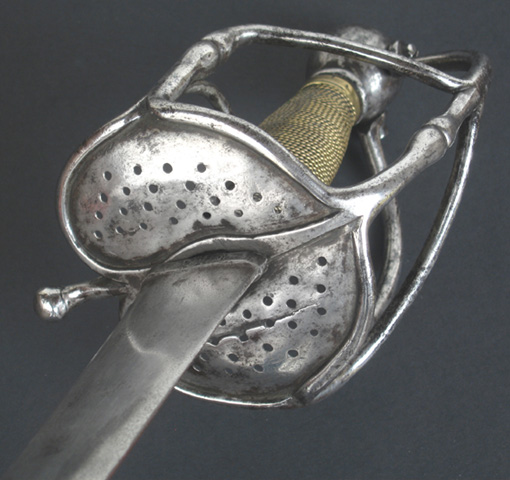

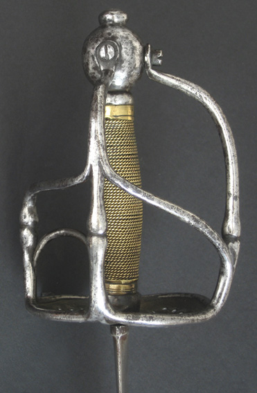

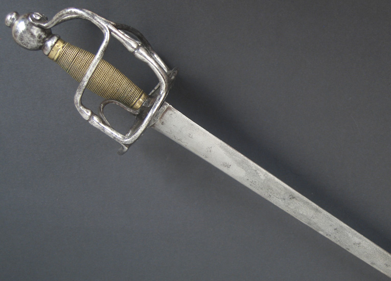

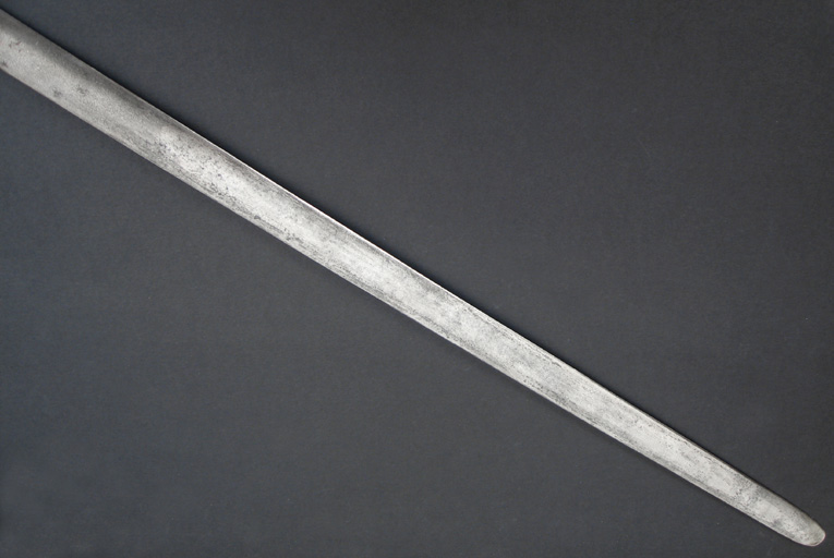

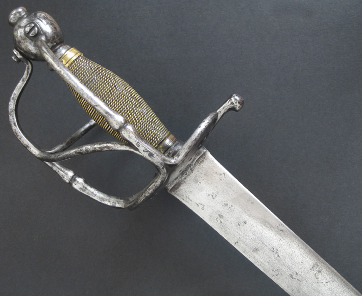

Hello, would somebody help?
This piece is on its way to my little collection.
Said to be German, dated around 1700.
Blade length 91, 5 cms
Width 38 mm
There are some numbers and letters marked on the pommel - LCR N118 - said to be regimental markings.
I would like to know your opinnion on this sword, namely on its age, country of origin and, if possible, an idea of the markings provenance.
Thanks a lot in advance.

That is a handsome sword. I've looked at a few 17th sword photos and this is the first time that I've seen writing on the pommel. I can't see it, but is there a maker's mark (or any other mark) on the blade? I wonder if sometime in it's history somebody decided to blunt the sword tip.
Some would disagree, but I don't consider this a Walloon sword. In my tighter definition, I say Walloon swords were made around 1650 in Solingen for Amsterdam town guard and other Dutch entities, and about 30 years later France ordered them from Solingen (through Amsterdam) as their first standard army issue sword. They have a pear-shaped pommel with a knucklebow screwed to it, but no side branches. The counterguard is heart shaped with a star and smaller circle perforation pattern. The picture below shows a typical Walloon sword.
In my opinion, better names for your sword might be:
1 - German Military sword
2 - Haudegen (Hewing or Shearing sword)
3 - Felddegen (field, or battlefield sword)
For more pictures and a discussion of these swords see this thread - http://www.myArmoury.com/talk/viewtopic.php?t=13795

Perhaps if it had big germanic quillons, as I have seen on, some, I might call it something like a "late 17th to early 18th german military cut and thrust", There are few of these available where I live. But I think your sword qualifies as a German "walloon pattern" sword. And a damn nice one as well. Congrats!

Concerning marks on the blade, i haven't yet received the sword; the pictures i posted are those from the seller's website. But i don't think there are any; soon i will check.
About the blunt tip, i must also check it when i have in hand, but i have already read the most varied opinnions on how this type of tip appears in this type and period of swords.

Fernando, another thing about your sword. I think its unusual for a sword dated that late to have the knucklebow and branches screwed into the pommel. By that time, I think the screws had been discarded and the branches inserted themselves into depressions in the pommel. But there are always exceptions to the general rules.
And that really is a beautiful sword. It is pleasing like that the double lobes on the branches and knucklebow have a restrained shape and aren't as bulbous or exaggerated as they are on some other 17th century German swords.

First is the inscription on the pommel; there is one more (tiny) digit in the legend, which confirms this is definitely a regimental numeration. The correct inscription is: LCR Nº 118, not punched but hand engraved (chiseled) in a crude manner. Oh, i wish i could have this marking decoded. If it were english, one could imagine the initials of Light Cavalry Regiment, but both in German and in Dutch one or another letter doesn't coincide ... at least in the translating machine.
The second is, as i guessed since i saw the first site pictures, a faded inscription engraved on the hilt side bar, most certainly the name of the sword user. After a zillion trials, i managed to get a close up picture where we can discern such detail.
