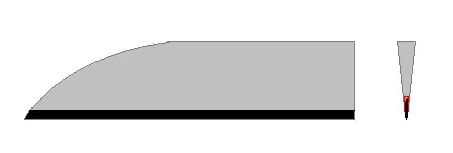

Understanding material properties better now, I know that in order to have a slicing-sharp edge, the carbide would have to be too thin for use in a sword (it IS much more brittle than steel), so my first project was a small knife.
For the body of the blade, I used aircraft aluminum, because it was what i had, and for the edge, I used a micrograin solid-carbide planer blade. I wanted to use steel so I could braze the edge in, but aluminum was what i had, so i had to go with glue, which was more Aztec anyway. Since I set the carbide into a deep, tight groove in the aluminum, the glue was really only forming a fillet at the juncture of the two materials anyway, so I wasn't too worried.
The result was better than I expected. Aside from suffering scratches on the soft aluminum body of the blade, the knife has suffered no damage while cutting into, among other things, a carbon steel razor blade, a glass bottle, and a red brick. It is also excellent for trimming my nails! I will not be striking the knife, or getting it hot, because I am sure that it is too brittle and the glue will not take too much heat, but for everyday use, it is pretty cool to have a knife that will literally cut anything except diamond.

Well, the camera we have (or maybe the operator) apparently can't resolve features smaller than a barn, so the pictures are pretty bad. Instead, here is a drawing of the knife and a detail of the blade. Light Gray is aluminum, red/orange is epoxy, and black is Tungsten Carbide.
As a side note, I shaped and sharpened the carbide with hand grinding on a diamond bench stone. It was much easier than I thought it would be. The carbide ground very similarly to flint, but smoother, if possible.
