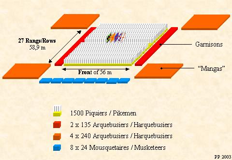

The relation between pike and shot went up to 1:1. I think not more than 2-3 rows of musketeers would find shelter among the leveled pikes. So there still would be enough of them left without cover.
BTW there is interesting page covering lots of details on the spanish tercio (though not my question).

It's also worth noting that there were more than one method that Shot could use to shelter from Horse. I've mentioned two--ducking under the pikes and repelling the Horse by fire--and there was at least one more, which was to dive for the nearest piece of bad terrain that the Horse couldn't traverse easily. Rocroi was probably not fought on the pool-table flat plain depicted in the movie so there ought to have been many pieces of terrain that unlucky Shot could duck behind.
Some of the Shot might have got cut down anyway, but as long as there were not too many of these then I don't think there would have been a problem.
http://www.geocities.com/ao1617/TercioUK.html
Note that the site has a detailed interpretation of the Battle of Rocroi--there's an English as well as a Spanish version
