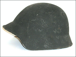

Inspired by an SFI thread about a conversion of a Swiss military helmet into a surprisingly nice Kabuto, I've decided to take an old, Vietnam era, US military pot-helm and turn it into a basic sallet.
I've gotten a sheet of 16ga steel, and I'm figuring out the pieces with oaktag paper, and marking them out on the steel. An order of brass rivets is on its way from Ebay. I still need to anneal the edges to I can trim some of the flare and eventually drill for the rivets.
I'm debating going in a semi-fantasy route, using whatever steel is left over to make some form of simple wings or crest. I don't demand historical perfection, so arc-welding may or may not be involved at some point. If I do wings, I'd probably want them as part of the faceplate, extending from the top of the hinge-piece. And before you ask, yes, part of my inspiration of the design comes from Nightmare, a character from the Soul Calibur series... Razz
Thoughts? Criticisms? Advice? Musings?

hm, for me you are going to work as much as to make a new one from scratch.
Shape is pretty far from a sallet and modern steel helmets are tough steel.
I would perhaps try a swiss 1918 helmet, whose shape already reminds of a XV century sallet, after which it was inspired.
But the shape of the swiss doesn't suit me too.

Hi,
I have to agree with Bruno here, it is never going to make a particularly nice shaped sallet, and with all the work involved in cutting, drilling, polishing etc. personally I do not think it is worth it. However, if you can find a paratroopers helmet, that can be made into a form of sallet, again not too convincing, but passable.
The steel of these helmets is very hard, even with annealing. In fact the last time I tried it some thirty years ago, the only way to 'drill' the holes effectively and easily was to blast them through with an arc welder! Eek!
The Swiss, and even better still, the American helmet would lend themselves much better to the Japanese kabuto, especially the overall shape of the san mai bachi, than the sallet (BTW. san mai bachi literally means three plate (helmet) bowl, but the overall shape is similar to the American helmet, especially at the peak ).
If you can find a paratropopers helmet ( NOTE: not a German or British WW II example, as both of these are worth a small fortune Exclamation ), you will get a better overall shape, but it is still a lot of work.
Why not try hammering one out from scratch, you will learn a lot and have a lot of fun on the way !
One final thing, for a sallet, the bottom edge of the visor is best cut slightly concave, not convex down to a point as you have in the photograph. I hope that you don't mind my saying that, just that over the years , I have made quite a lot of sallets !!
Good luck whatever you decide Happy
Regards,
Russ
Carpe diem, quam minimum credula postero !

Thankyou, both.
True, I'd much rather use a closer helmet style. One of the Swiss helms would be fantastic. Alas, this helmet was free and my budget is limited, myself being a broke college student.
I know it won't be perfect, but I think it will atleast look good. I don't have the tools, skill, or free time needed to dish out a whole new helmet, but I think I should be able to form a few pieces and make a few additions. The look doesn't have to be perfect, and I'm not really basing it off anything historic(sallet is just the basic idea, I might borrow from other designs as it continues), so I'm not holding myself to any strict rules. Overall, I'm basing a lot of my current work on this little guide I found:
One thing I'm thinking about right now is the lining/suspension. I've seen padded liners, and I was wondering if anyone has ever tried using pieces of memory-foam? I have some substantial scraps from an old mattress, and it absorbs shock really well and is also quite comfortable and form-fitting. I'm thinking cutting it into stripe, and sewing it into a linen cover, then using a decent adhesive to set the whole thing into the helmet.
