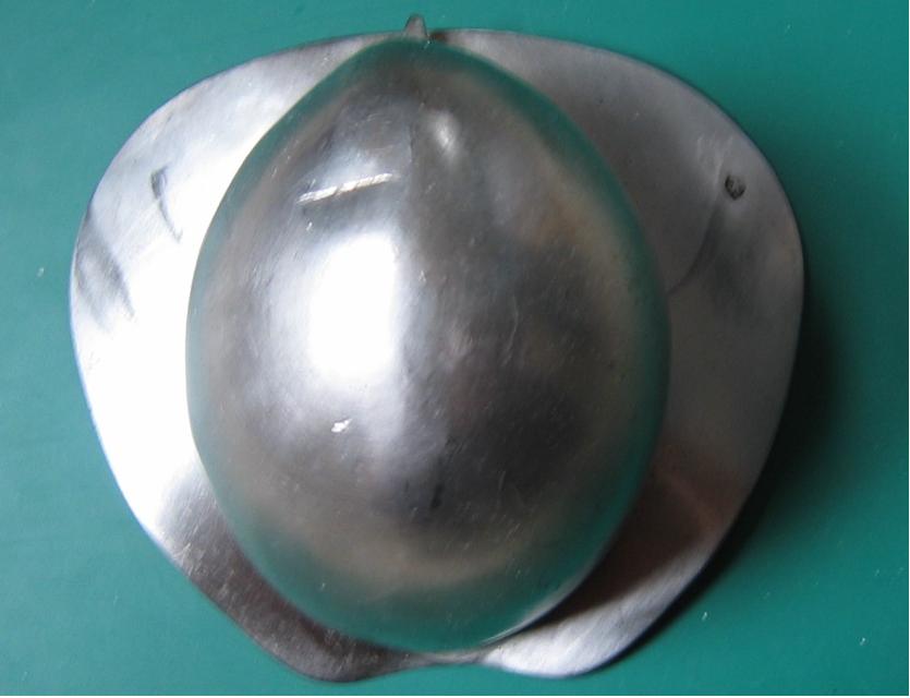

PostPosted: Wed 20 Aug, 2008 8:33 pm    Post subject:         Reply with quote
Hi, codpiece both decorative and extremely utilitarian were standard on 16thC foot combat harness
both my brother and my self wear 3/4 armours with steel codpiece and they protect just fine.
The codpiece sits over the flap of the hosen or is filled by the material codpiece which contains no part of the anatomy either! (remember everyone wears codpiece at this time and a groin plate has to be shaped to fit it)
It is the steel base plates that extend from either side of the codpiece to cover the crotch gaps in the tassets that is the real armour component of these pieces
As to effectiveness, for some reason every one aimes at the EMPTY COD!! not at you, And a curved surface like that dissipates force very very well.
My brother was once hit at full speed with a Zweihänder on the tip of his codpiece and he didn't know or even feel it untill we all pointed out the dent to him!!
 Attachment: 38.4 KB

Ushio Kawana wrote:
Dear Robert MacPherson
So I think "Why a vital part was projection?"
Dear Ushio Kawara,
If I understand your question, you are asking "why does the codpiece stick out?", and "doesn't that compromise its protective value?"
My reply is that it probably does compromise its protective value.... but only very slightly. On the other hand, the little it loses in protective value is more than offset by its gain in stylistic value. Projecting codpieces look strange to our eyes, but to sixteenth century Europeans they looked normal and stylish.
Armor was subject to the whims of fashion then, just as clothes and cars are today. People will always buy what looks good to them, as long as it works almost as well as the thing which does not look as good. People are like that now; they were like that then; and they will always be like that in the future.
Mac

Craig Peters wrote:
Ushio Kawana wrote:
Do not you think it to be easy to take attack?
Ushio,
In my experience, the groin isn't the easiest location to attack. The reason I say this is because it is difficult to specifically hit a codpiece with a cut. You're far more likely to hit the leg or the hip with a cut first. So that means that a lot of the attacks made with a sword, at least, are not likely to strike it. On the other hand, a thrust is still very dangerous, and it's not too difficult to hit someone in the groin when thrusting. It can also be possible to hit someone's codpiece with a vertically rising cut, although this is still relatively uncommon.
Agreed. Another factor is the instinctual reflex to protect one's groin - it's hard to land a groin shot.
