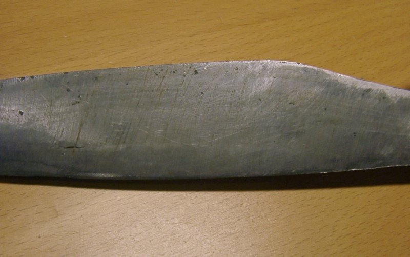

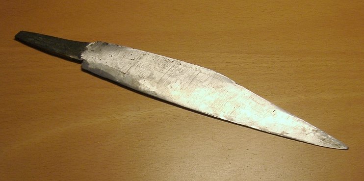

Well, here's a blade I'm working on at the moment. It's not polished, nor etched, and although nowhere near as obvious as on etched blades, the layers are clearly visible. And in this blade most of the layers, aside from the edge, are layers of the wrought iron. With alternating iron and steel, the layers would have a higher contrast. I do recall that in one of the old sagas (don't know which one), a sword was described as revealing a snake running down the blade if it was held at a certain angle in sunlight. This would indicate that the patterns were quite faint, therefore not etched.
 Attachment: 48.93 KB
 Attachment: 58.74 KB

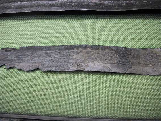

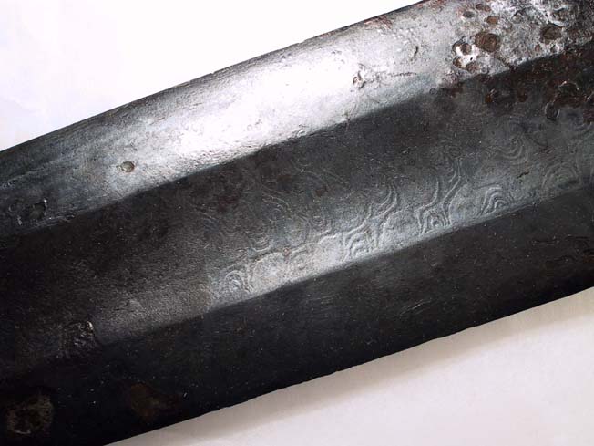

Peter Johnsson
Location: Storvreta, Sweden
Joined: 27 Aug 2003
Posts: 1,757
PostPosted: Thu 28 Aug, 2008 9:14 am    Post subject:         Reply with quote
Jeroen, I would caution against make assumptions of a general nature based on how sagas describe details. In the case of your seax blade your idea to leave the surface without etching is a good one. In those cases where the structure was less a decorative effect and more a result of manufacture, I do not think it was enhanced.
In some cases fully pattern welded blades might not have been etched, but then I would think a rather advanced polish would have been used to bring out the effect. I do not think the structure was left mostly invisible.
The saga might mention the fact that the serpent was so discreet, simply because that was a noteworthy thing in a world where most patterns were readily visible. Alternatively, the saga could have been written down in an age where pattern welded sword blades were a rarity, and so a thing of legend and fascination (and just as they are today, regarded with much wild fancy and romantic notions).
Concerning pattern welded blades and how their pattern was revealed: Most originals are in no state of preservation to give us a clear idea of their original surface. I do agree with the notion that sometimes only careful polishing could have been used to reveal the pattern. I do suspect that mild acid (vingar, friut juice or some kind of chemical compound/fluid) was sometimes used to enhance the effect. In some cases the etching is more than just a mild enhancing: it is a matter of deep etching to produce a topographic effect.
There are exceptions to the rarity of surviving examples. Sometimes blades that has been preserved in oxygen free (or near so) conditions can have areas of original surface surviving. One sword from Fullerö just north of Uppsala has sections of the blade where the original pattern and character of the surface is very evident. This sword shows us many things: they could achieve very good surface finish. They did use etching (In this case rather heavily) to enhance the pattern. The effect is topographic (by this I mean that the etch is so deep that some layers stand proud and others are eaten away to some depth). Note the the pattern is etched in the fuller only. The edges show color contrast between the layers, but not deep lines etched in. This viking sword is thought provoking in many ays. It is rewarding to keep looking at it and note all the details that stand out in shape, surface, finish, sharpness and so on.
The second example is a celtic blade (LaTène II, 2nd C BC?) with patterned centre, where selective etching has been used to reveal the layers to dramatic effect. The edges are damaged, but the effect you can see in the centre of the blade is much what the sword would have looked originally: an etched field running down the centre of the blade coinciding with the piled core inside the welded on steel edges.
