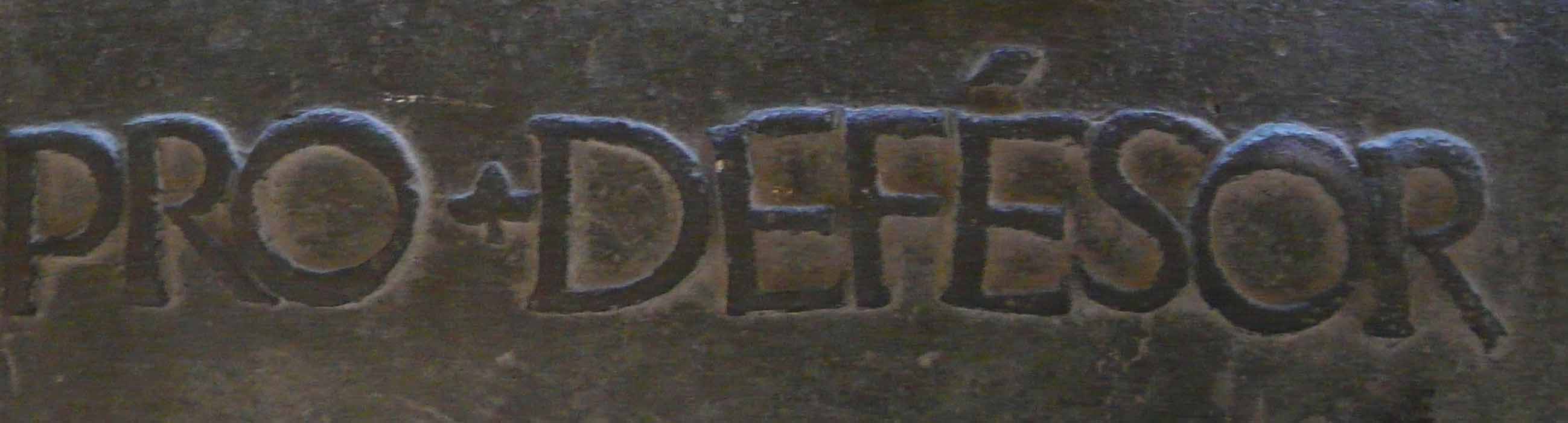

This thread is a bit old, but just one small bit of information for Mr Al Muckart if he is still following it :
I'm also trying to work out correct abbreviations. Part of why I'd like to find pictures (if there are any) of extant engraved swords is to see how the abbreviations were laid out and if there are any marks indicating the termination of a word etc.
During the Middle Ages abbreviating was a very, very common practice, and not only on swords - it was first and foremost used with manuscripts (to save parchment and time). Now there were rules for abbreviating, so that what one clerk would write could be read by another clerk. The degree of abbreviating varies with the texts, some being more severely abbreviated ; but there are some basic abbreviations that are found again and again throughout the texts and centuries. A few examples using what you want to inscribe :
"am" or "an" is often abbreviated using "ã" (not exactly a modern ~, but closely resembling it). Thus : "pergam" would become "pergã".
Likewise, "er" is a very commonly abbreviated pair, using some kind of ' (see picture below). Thus, we can further abbreviate "pergam" into "pe'gã".
However, this particular word would even more probably be abbreviated by using a symbol for "per" (a very common praefix in latin, thus a good target for abbreviating). This symbol is like a "p", but with a horizontal bar crossing the vertical one (pictured below, as well as other abbreviations including the ~ - as you can see these abbreviations retained usage even in other languages than latin, here Middle French).
By using it, "pergam" can be reduced to "pgã" (using of course the "per" sign in lieu of the "p" I just typed). That's about as far as you can go, I think, but this example shows that by using very common abbreviations you can reduce a word by 50%.
Now I am only a beginner studend in latin paleography (study of ancient writings), and I do not even have my books at hand, else I'd try to abbreviate the whole sentence. There are other obvious possibilities - I'm sure there is a way to abbreviate "ubi", and the word endings are another easy target - "perexeris" would become "perexer, ", and likewise "moratus", "morat, ".
I know these abbreviations are not limited to parchment/paper. A few days ago I witnessed the classical "~" used on a gun (see attachment below) : above an "E" to make "PRO DEFENSOR" into "PRO DEFESOR". I have no proof of it being used on swords, but I do not see any reason it could not have been.
I would suggest that you seek a dictionary of latin abbreviations (I use the Dizionario delle abbreviazioni latine ed italiane by A. Cappelli, which is very good and a recommanded buy if you are interested in paleography - it's quite cheap, multilingual (in fact it's in latin, as it is not aimed at translating, only transcribing), and reproduces period handwriting for added authenticity).
Have luck with your order. I am thinking about ordering a custom, inlaid sword myself, perhaps by Peter Lyon, so... Let me know how good he is at inlaying ! Wink
 Attachment: 80.5 KB
Abbreviating on a gun [ Download ]
