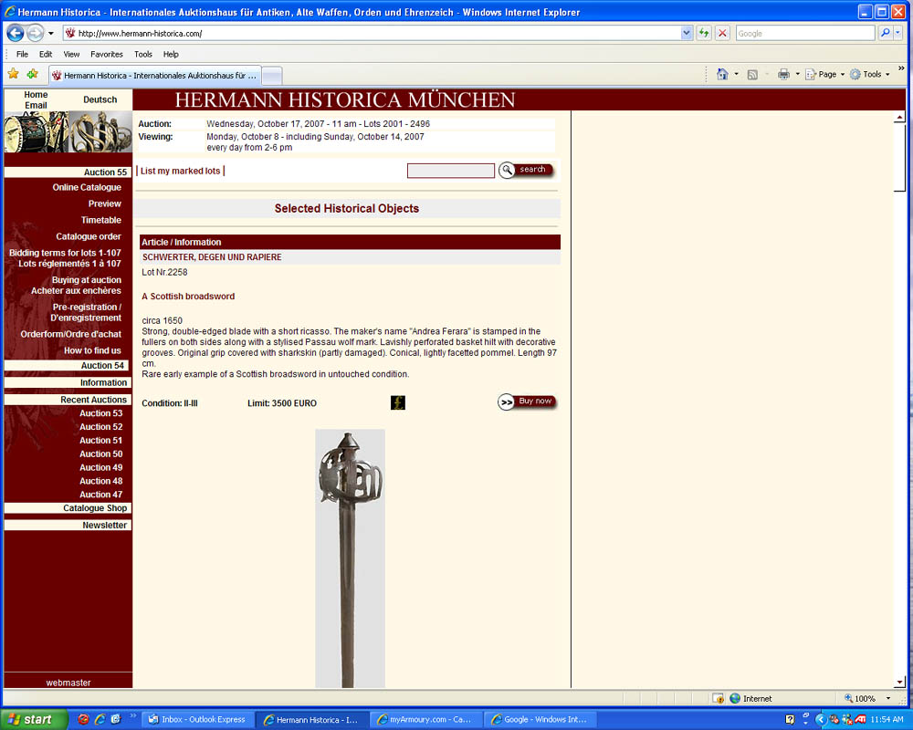

PostPosted: Thu 29 May, 2008 12:07 pm    Post subject: Re: Can you help me identify?         Reply with quote
Hi Erin:
Chris Gregg is right about the sword identity and the potential value. I am attaching a screen grab from a past German auction late last year that shows a very similar sword for sale, although in slightly better condition than yours. You can get the relevant web infor from the screen grab and perouse their other catalogs to find other examples.
It's definitely worth keeping!
