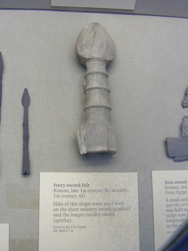

I'm not sure where this picture came from, but I believe it is an Ivory hilt.
 Attachment: 90.29 KB
...and if I had bothered to read the description I would know it was Ivory. :blush: [/u]
