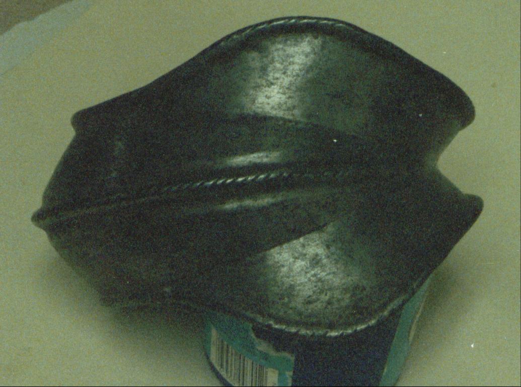

Hi everyone!
What do think about that counter? (found in Lithuania during archaeological excavations)
I really need your opinion. Thanks
Russ Thomas
Posted: Sun 20 Apr, 2008 2:56 am Post subject: Couter.......... |
Paulius,
I would say that it is Italian or French, ca 1560-70. It may be German, but I do not think so. Personally, I would opt for it being Italian. James Gillaspie or Doug Strong are the persons to ask really. They know far more about armour than I do. But that is my sort of educated guess.
Regards,
Russ

I would like to identify that particular specimen as a 1520's Nuremburg manufactured Max piece. This is based upon the the general flowing full-circumferential one-piece design, heavily roped edging especially at the elbow cusp, and lack of articulating lames pointing to direct attachment of the cannons and rerebraces...

Russ pretty much nailed it. Yup. It's a standard type that shows up around 1550. Seems like all the collectors have at least one.

Yes, I should have been paying more attention to how LATE the style goes. I was thinking about stratigraphy, and how early the sample could possibly be dated to. Similar couters were in use much earlier, but the really tiny ones, like the above, are usually Italian or possibly French. German ones are almost always bigger, in my experience, except for the following (makes me wonder, though, if there aren't earlier German ones. Could be, just don't remember any examples). Very similar couters do indeed occur on some of the late munition 3/4 armours in the Graz arsenal (so we have to throw the Styrians into the mix!). However, they just don't have the heavy roping on the borders that this one does, which is more a midcentury trait; not that you'd expect to see much heavy roping on a munition piece, anyway. Here's a typical Italian example, c. 1560, from Wade Allen's collection. EDIT; Hmm, after looking at the dimensions on the excavated piece, if that scale is correct, that's one hell of a BIG couter for one in this style. Wade's is approx. 7 inches (178 mm) from back to front. Must have been made for quite a large fellow.

Oh, and here's a bigger pic of Wade's - it really is a VERY good match for the excavated piece, except that the recessed border appears to go all the way around on the excavated couter.

Great! That couter was found in a layer of end of 16th century
Many thanks! Your information was very useful for me.

I stick quite firmly to my original thoughts regarding this piece, Italian or French 1560 -70, but probably Italian I think. Yes , it could be a bit later or earlier,and it could be French, but I don't think so. Any way that is my two cents, lire, ecu, pennies, Øre or whatevers worth! I am quite certain, (for whatever that is worth ! ), that is is not German.
