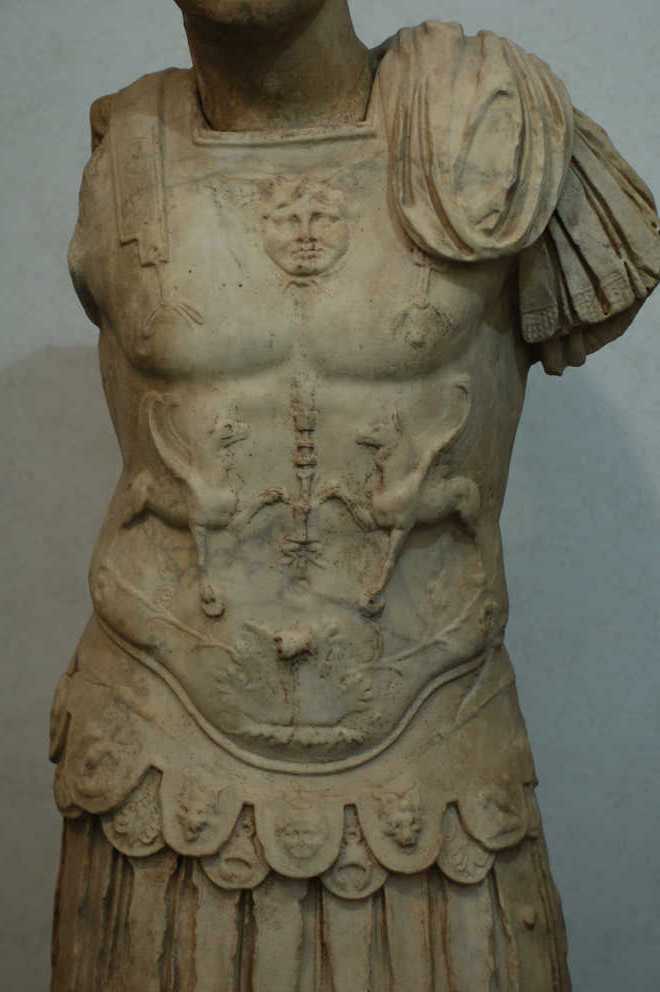

i know that any armor make it a bit harder to move or bend, I have got a gothic breasplate and I don't bend much. But my breastplate is in waist like x, it is bigger at upper part of chest and smallest in waist and bigger at hips (it's little bit like skirt). I give image, it will be better. But i mean that the muscles on cuirass on statues ends on underbelly (i mean lower part of abdomen, i don't know if its right term), i think that this is little unconfortable.
I forgot images.
There is gothic cuirass http://www.by-the-sword.com/acatalog/images/dc-509.jpg, it is similar as mine.
And this is statue of man with muscle cuirass http://www.romancoins.info/DSC_0025.JPG.

The short answer is that for the Roman Imperial era, we really only have artwork, since no known originals have survived. (That's no big surprise, since the number of officers was comparatively small, and their precious items would be well cared for and not easily lost for archeologists!) From earlier times and other places, however, there are plenty of bronze cuirasses, so it's pretty clear that bronze was most likely the common material. But it's also possible that strictly ceremonial versions of these cuirasses were made from fabric or leather--some shown in artwork are obviously flexible. But I would not call these "armor"!
Metal cuirasses made for battle would not be so long as to inhibit movement. They would only come down to the waist, so that the wearer could bend easily. The embossed muscles and other features on the cuirass do NOT necessarily match what is directly underneath!
