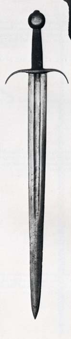

Here's a pic of the original sword, from the Christie's sale catalogue of Howard Curtis's collection (this sword was in Oakeshott's collection, the Douglas Ash's, the Howard Curtis's, now?).

Interesting review, now that I've had a chance to read through it. What I miss in it are straight-on overall and hilt shots. Angled shots make it hard to tell some of the proportions. The hilt seems a bit off from the original in shape and maybe size, but without a straight-on shot it's hard to know.

Thanks! In putting the two side by side, it's obvious there are some differences:
[ Linked Image ][ Linked Image ]
The blade looks to be about the same width as the one in my larger pic of the original (it should be proportionally smaller). Ditto the grip length. The thickness, width, and curvature of the guard are also different, though the perspective could be skewed by the size of the grip and blade.
If those are to scale then...I don't think I like the reproduction at all.

The pictures are not at the same scale. But looking at two pictures of different scales, you shouldn't see a grip length and blade width match... :)

Yes this was the first and all we had was the picture, and blade length, not a scaled drawing.
In the information on the review from Mike and Adam we are going to shorten the handle length by 1" and also slim the handle down.
Also the blade width will be cut some as well, which will make this little sword even quicker and faster.

Comparing the two in the pic the prototype looks/feels like a huge dagger while the original looks/feels like a small compact short sword: It really is all because of very subtle differences in handle, blade width, blade length, handle thickness.
There is also the issue of wanting to copy as closely as possible the proportions/size of the original or making a sword based on the original but with different but still good looking proportion on it's own merits i.e. A design decision, but either choice could work. ;)
Since the original is so harmonious and attractive in proportions I would choose duplicating it as closely as possible.
