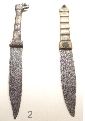

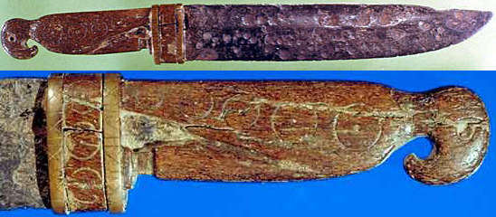

I'm also attaching a photo of some carved seax handles that you may appreciate!
-Tim

Mind that the saxes in that picture are really small knives, only about 17-18cm total length IIRC. Larger saxes, if any hilt material survives, it's wood. The small sax or narrow sax type sometimes has metal bolsters and pommels. Most other types of saxes however didn't. For more information:
http://1501bc.com/files/information_about_saxes.zip

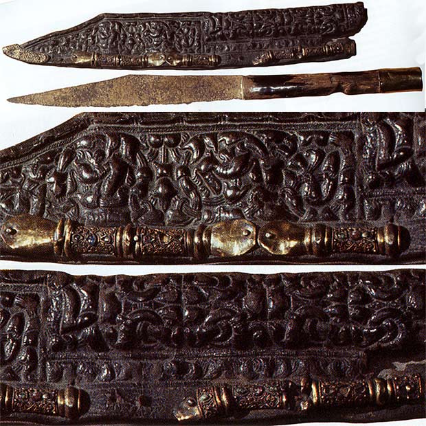

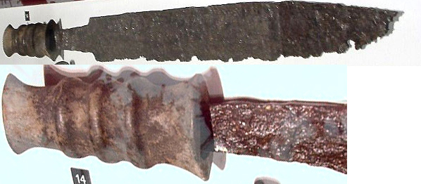

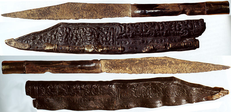

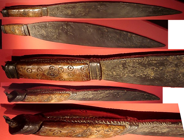

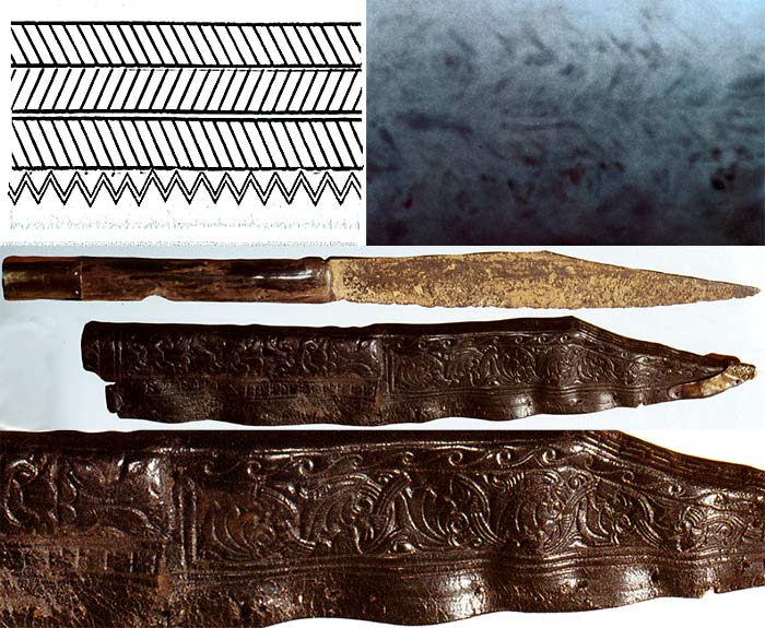

With seaxes we have mostly only blades surviving.
In most cases there are at most traces of of the leather from scabbards sometimes and sometimes traces of wood of the grips.
We have to build our idea of how they looked based on the remains and those are pretty meagre.
We might conclude that the only possible solution is to make the grip a plain and unadorned wooden grip. Personally, I think that is not the most realistic solution, even though the finds rarely supports anything further than that.
I have run across a number of seaxes in museum store rooms. I have documented perhaps forty of different type and from different time periods. In Uppsala where I live there is the store room of the Univesity collection where many of the finds from Vendel and Valsgärde are kept. These are rather special and perhaps unique. It is difficult to say how much they tell of seaxes from other parts of Europe. What they show hints at a rather rich and flamboyant expression, rather than the stark and simplistic.
The weapons from Vendel and Valsgärde are unusually well preserved. You can see how the scabbards are constructed and decorated. They are built with a wooden core made up from four parts. These are leather covered and adorned with decorative nails and/or panels with zoomorphic knotwork. At times the inside of the scabbards are lined with fur.
The front side of the wood cores are sometimes carved with knotwork, that show through the thin leather that is glued on top.
This is a method of decoration that can be observed on other seax scabbards (finds from Gotland for example). The very same technique is found on late roman and early migration period sword scabbards: skillful and intricate carving of the wood that is overlayed with very thin and fine leather.
The grips of the seaxes from Vendel and Valsgärde have wood cores and in at least one case, the core is made up from two halves that are glued together (like the grip core of a Japanese sword). The grips are then covered with thin leather and in several cases decorated with geometric patterns of silver or bronze nails (with domed hollow heads). The effect of this nail decoration is rather similar to that you can see on the rifles of the Indians of the ”wild west” in the 19th C.
In some cases there are remains of bronze mounts on the grips. One or two cases of rivet blocks (an unusual feature), but there are also discolorations of the leather that makes me think that there could once have been thin strips of bronze at the forward and perhaps aft end of the grips, over the leather. This is a guess, but it makes sense if the grip was made in two halves and glued together.
In archaeological reports you can sometimes see that there are remains of glue and animal hair wrapped around the tang of seaxes. I think this is the remains of a hollow bone grip that was secured with a mixture of glue and hair. The bone is gone and only the glue/hair mix remains.
Once I did a reconstruction of the contents of a warrior grave excavated just north of Stockholm, Tomteboda. There was a seax of unusual shape, that proved to be interesting. In photos of the excavation you can make out the seax in situ. You can see the outline of the scabbard and the grip and discolorations where there were oxides from metal mounts.
In the earth you could see traces of corrosion in bands across the scabbard, suggesting a mouth band and a chape and reinforcing bands along each side. There was also discolorations in the grip area. Nothing solid had survived to study however. It was all just dirt with inclusions of salts and rust.
The scabbard seems to be of similar type as those well preserved examples from Vendel/Valsgärde. Conservation report told of traces or remains of hair (from deer) and glue wrapped around the tang of that was cleaned away from the blade during conservation.
The grip did not survive, but there were details in the corrosion close to the end of the tang (that had been bent over the end of the grip) showing there had been rivets securing some kind of mounting at the end of the grip.
If I were to offer a personal guess at the original design of the grip, I would say that it had a wooden core, metal reinforcing band at the ends, a carved knot work decoration that was covered with thin leather.
For the actual reconstruction we had to be strict with the interpretation, so a simple bare wood grip with a reinforcing "cap" or band at the rivet end was made. I am not convinced that was how the weapon actually did look.
To interpret the meagre material remaining of the mounting of seaxes we have to try to draw conclusions from parallel finds. I think it is reasonable to look at other types of scabbards and knives. It is common to see decorative features, often as carvings. Nothing of this remains, even in those cases where there are traces of wood sticking to the tang. To make a representation of the grip as a very bare and simple ting, might be actually less realistic and authentic.
There are some grips preserved showing what the carved decoration might have looked like.
I think most of these are from scandinavian areas. The decorative style would naturally be scandinavian. Still, I think many (most?) seaxes from Germanic or Anglo-saxon areas were also decorated, at least with carving and possibly with thin metal mounts as well. If we choose to include such features, we need to look carefully at the decorative style of the region and period and we need to keep in mind that it is a suggestion to a solution. Not fact. To exclude such features might result in less realism, not more. It is a difficult dilemma.
The thing is that making reconstructions of seaxes, we *always* have to rely to some extent to guesswork. Only few examples have survived that hint at something more than blade shape. We know very little about the actual shape of the grips. There are some tantalizing hints in surviving material, but these show only details and only very few examples.
To say, based on surviving material, that seaxes *always* had simple wood grips is to me an exaggeration. We cannot know this is true. We have little support for the actual design and possible decoration, but to assume they were plain, simply because the surviving material is meagre or prove littel in the way otherwise, seems to me a misleading conclusion.
We know we do not know a lot about them.
Choosing a safe road including only the known might in this case lead us astray.
It is noteworthy that in many of those few cases were origial surface *does* survive, there is decoration and metal mounts involved.
We need to look at other weapons of the period.
We need to consider the decorated spear and arrow shafts in Danish material (they have painted and carved decorations).
We need to consider carved and embellished grips of smaller knives that can hint at decorative features used for seaxes.
We need to look at the decoration of surviving leather scabbards in the germanic material.
When this is all put into the picture, we might be able to suggest a *possible* solution for the design and construction of the grips of seaxes. We will never know for sure, unless there is a complete find. And then we will know what *one* seax looked like.
Jeroen, I am very much with you as you stress the importance of studying details and types. It is very easy to be led astray in the interpretation if we do not consider how well developed and specific this weapon was and how it evolved over the centuries. I am however also suggesting that we need to include a certain degree of calculated interpretation when it comes to mounting of the grip and the scabbard. So little remains today, that we need to rely on contemporary items to get a full picture.
I would suggest that the simple wood grip, might not be that simple ;-)
I would even go so far to suggest that to put a simple un adorned wood grip on a fine seax blade might not be very authentic.
We cannot know what it would have looked like for certain, but the material suggests a love for decoration and contrast in materials and colors. It is up to us to develop a sensible suggestion based on the complete material from the period.

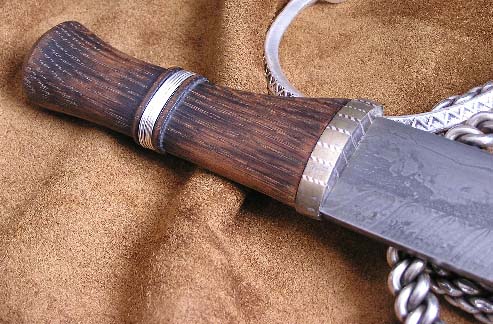

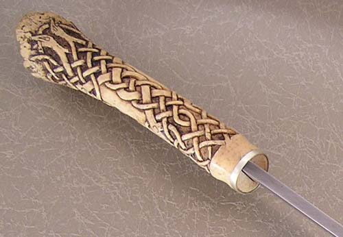

Here's perhaps a reasonable amount of license on a Frankish sax I made in '05, stealing design elements from sword grips... (wood, iron, silver)
And here is an extreme amount of license, from earlier this year, inauthentic to the Nth degree but a lot of fun to make and use Big Grin (carved oosik)
Both on large saxes, but that's all I got to contribute, perhaps some scale-able elements to them Wink
I think more contemporary saxes need leather covered grips.
 Attachment: 33.24 KB

Here are a few images I have of Seax with grip material....
ks
 Attachment: 57.63 KB
Bone Grip .NydamIV Bog Find. 450-475 A.D. Detail from Photo By Jeroen Zuiderwijk
 Attachment: 99.85 KB
Bone Grip with inscribed Circles. Rijksmuseum van Oudheden, Leiden Netherlands Compiled from photos by Jeroen Zuiderwijk
 Attachment: 147.94 KB
Wood Grip Raven Design incribed Circles. Netherlands 9th century Length 30cm Image from "Medieval Warfare Source Book Vol. 1 Warfare in Western Christendom"
 Attachment: 90.47 KB
Bone Grip Compiled from images by Jeroen Zuiderwijk
 Attachment: 98.79 KB
Knife Of Charlemagne. HornGrip. AechenGermany. Length 53cm Blade 31cm Blade Width 45mm Grip Length 22cm Max. Thickness 3.6mm. Image from "Damascus Steel"by Manfred Sachse
 Attachment: 99.96 KB
Knife of Charlemagne. Close up of Scabbard. Image from "Damascus Steel"by Manfred Sachse

The Nydam example is a double edged sword, and the hilt is antler. The fourth, with the bone grip is a double edged Viking period sword, which has one edge ground flat. It's a bit of an odd thing, as in the Viking period, longsaxes had already gone out of use (at least in the Netherlands, in the UK f.e. they may have lasted longer and in Scandinavia they had evolved into single edged swords). You mention the knife of Charlemange having a horn grip? Do you have a reference for that? So far I've assumed it's wood, as I don't see it possible to get such a large thick hilt in one piece from a horn.

Jeroen Zuiderwijk wrote:
ks
Hey Jeroen...
Thanks for the info.
In the file name I have written that it is a horn grip. So this info probably came from Manfred Sachse's "Damascus Steel."
take care
ks
Thanks! Any idea about the ferrule? From the picture it's difficult to say if it's bronze, brass, silver or gilded silver.
Hi Jeroen...
If I remember right, most of the info in the book was related to the blade. (There were X-rays of its structure.) I can't remember anything on the fittings... sorry!
The pictures are in color and it looks to have a yellowish color. If I were to guess, I would say gilded bronze.
ks
