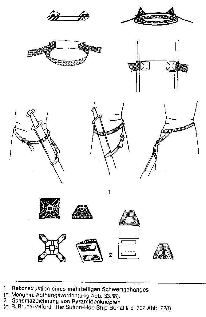

Here is an attachment from the book "Das Schwert im Fruhen Mittelalter" by Wilfred Menghin.
It shows scabbard belt suspension as found in germanic context, but I think one of the pyramid "buttons" is from the Sutton-Hoo find. That would mean the design can be used in english context.
Hope this helps.
 Attachment: 95.39 KB
