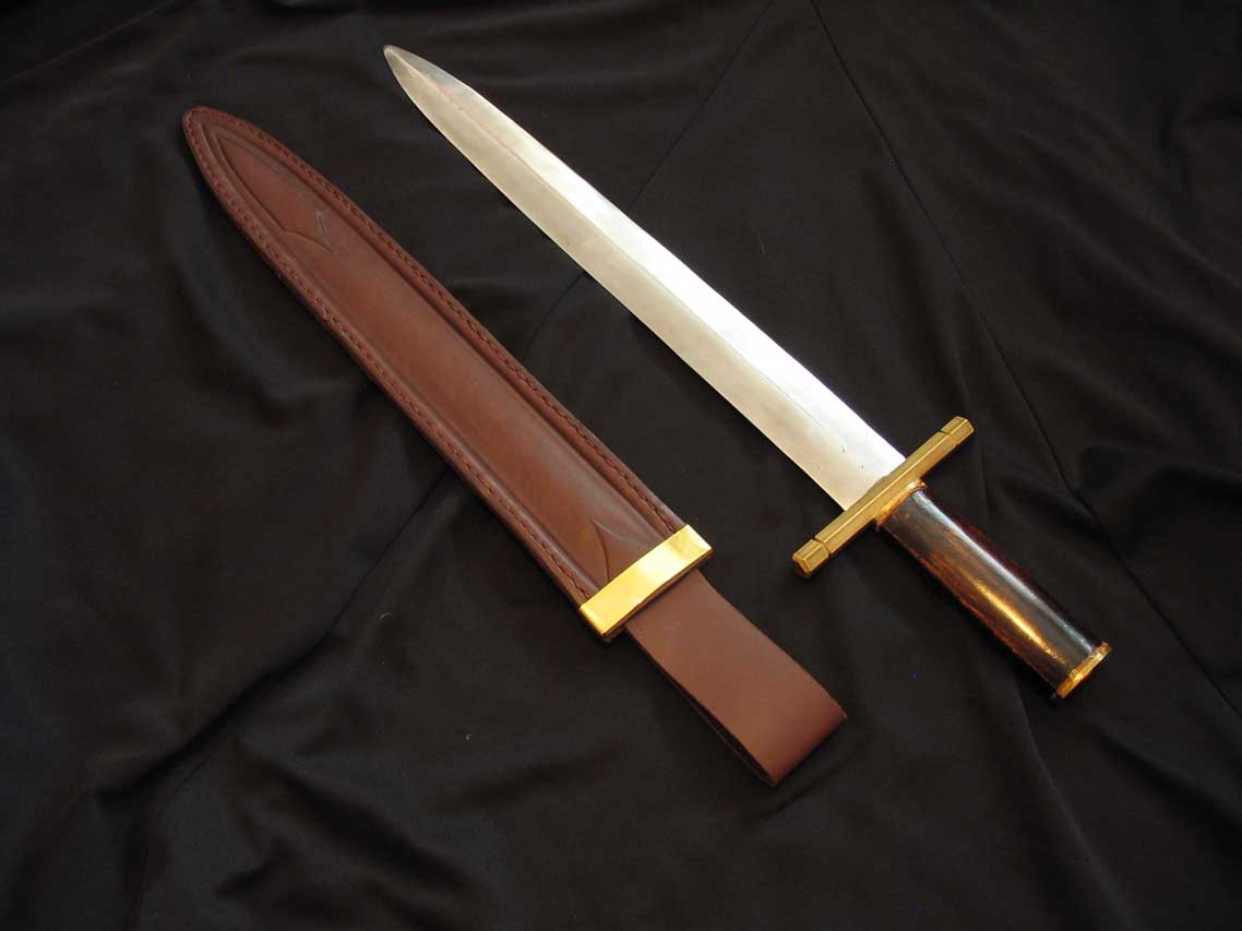

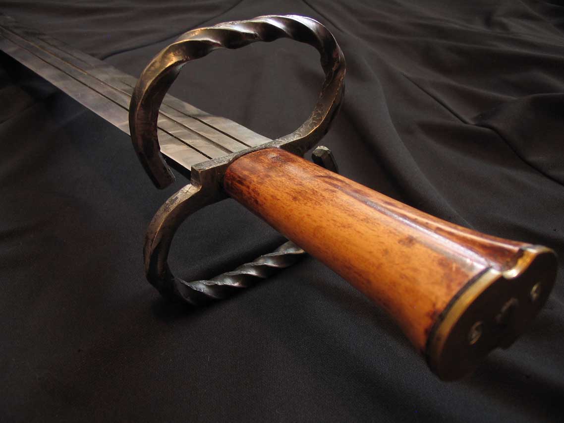

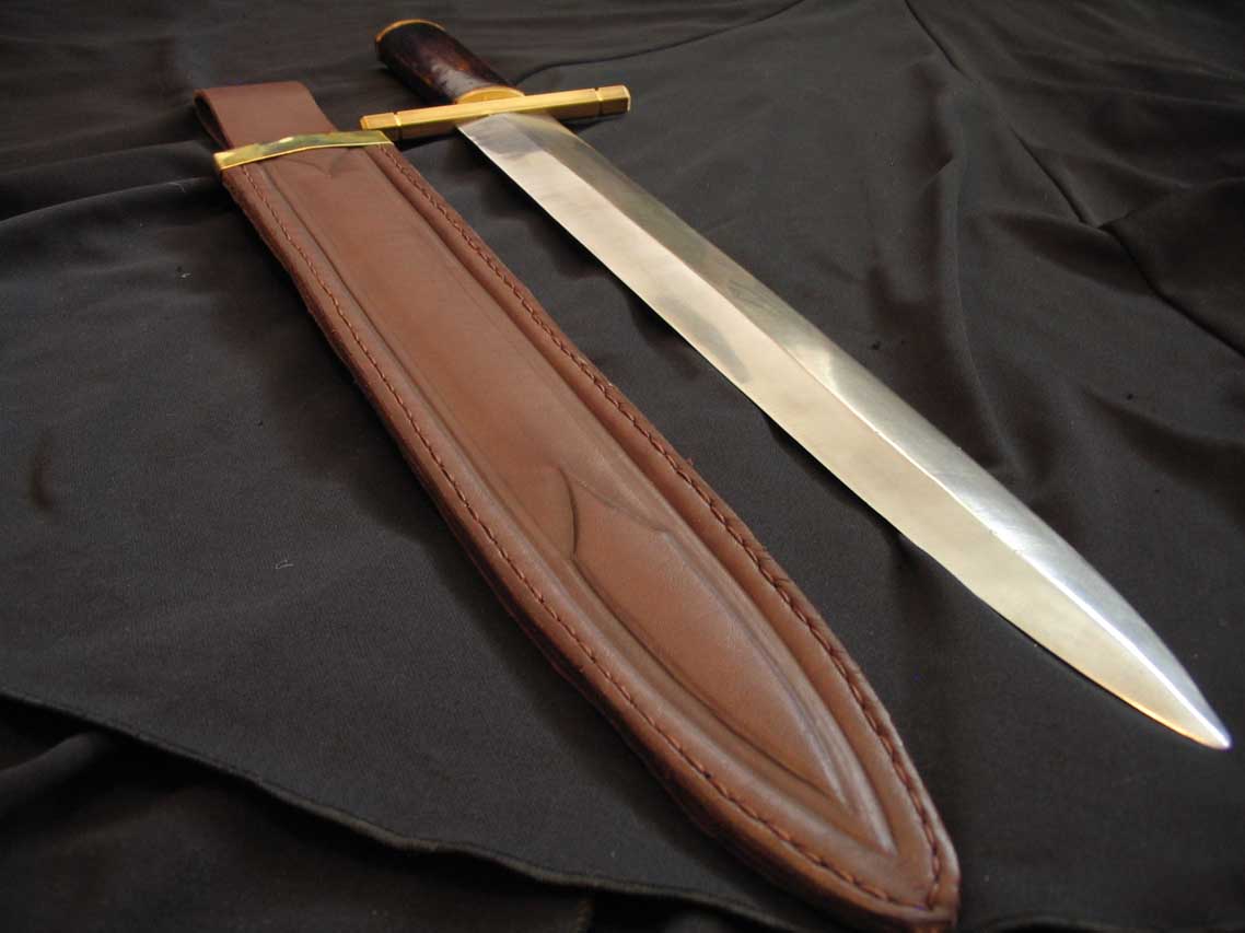

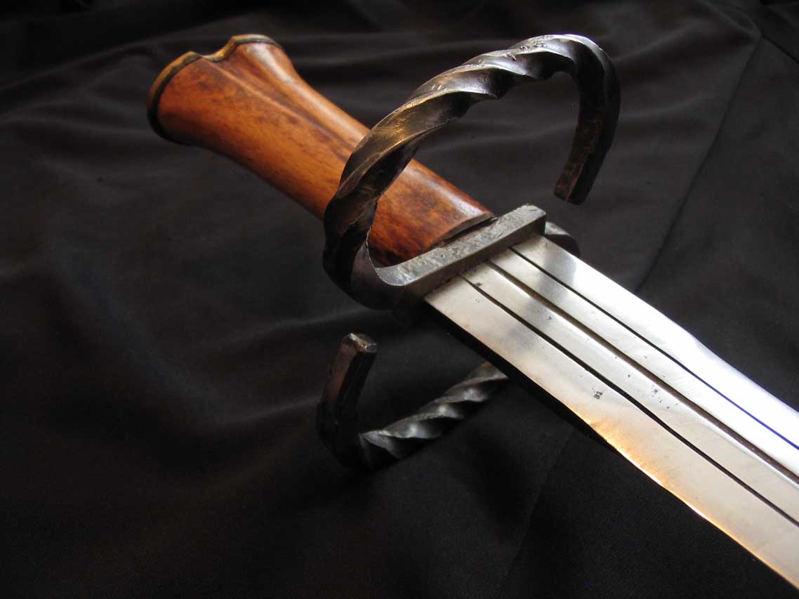

Tervehdys.
Here“s a couple of items I made during the summer. As the subject says, a katzbalger and a dagger. The blades are both made of leafspring. Handles are from stained beechwood with brass plates. I treated the handles with gunstock oil, and they came out to be quite glossy -maybe a bit too much. At some point I might try to aply some wax to the handles.
Some measurements:
Katzbalger
Length: 65,5 cm
Blade length: 53 cm
Weight: 0,984 kg (I think it was that...)
Dagger
Length: 53,7 cm
blade length: 40,5 cm
I haven't measured the weight yet..
The katzbalger was something I wanted to try, because of the beatiful characteristic shapes of it. -And also, I didn't have one yet Wink The handle is supposed to look a bit used. I thought it would match nicely to the rustic-looking crossguard. Sword is still waiting for a scabbard. Oh, and the handle might still be a bit too chunky compared to the originals.
The dagger was the other piece from the large two-handed sword that I put in half. From the smaller piece I made the Holbein dagger. This dagger is quite big, and I don't know if it has any historical examples. Then again, it's not trying to be any reproduction...it's just an experiment. It could also be some kind of a big hunting knife, a think...
Some pictures attached.
-T

Excellent work Toni,
I especially like the grip on the sword.
Have you tried the kind of twist work that you did on the cross guard before? Its something I haven't had a go at yet. looks great.
Nick.
"The Riddle of Steel. Yes! You know what it is, don't you boy."
Toni R.
Location: Kuopio, Finland
Joined: 17 Mar 2006
Posts: 39
PostPosted: Wed 17 Oct, 2007 2:05 am    Post subject:         Reply with quote
Thanks Nick.
I've done actually quite lot of this kind of twisting before, but not on swords. I made forged paperknives few years ago, and used the same method with them. With katzbalger my heating equipment were a bit inadequate, and it was some hard work to do. But if you have have proper tools to work with, it's no big deal. Just heat the metal enough until you start to twist. Go for it Happy
-T

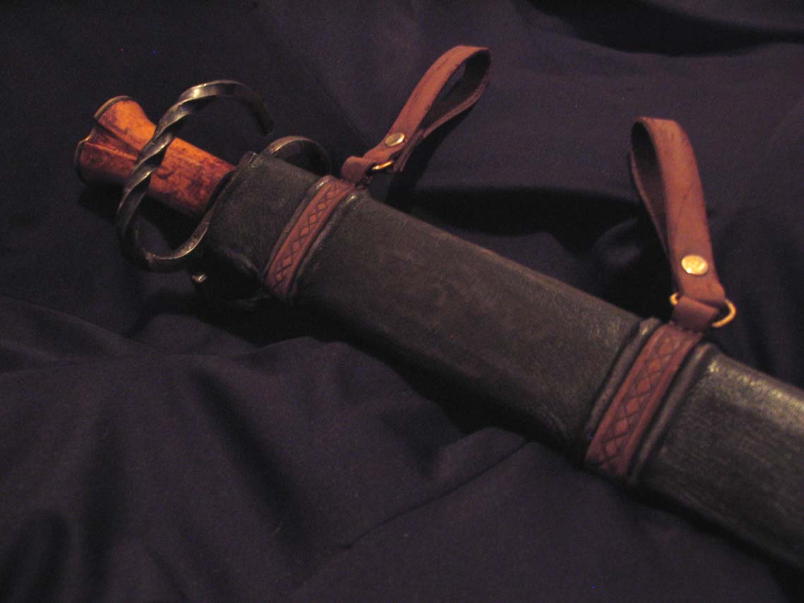

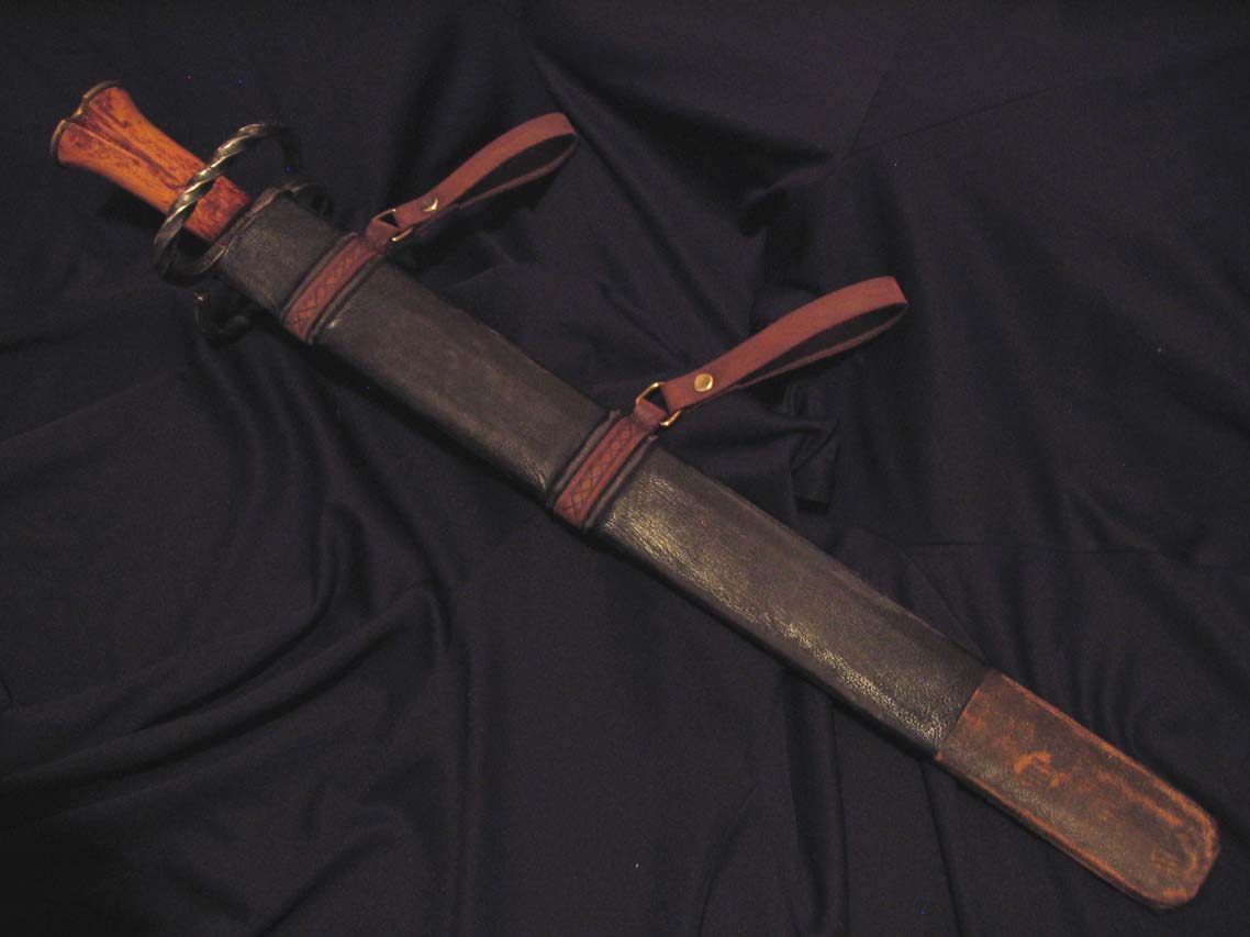

PostPosted: Tue 30 Oct, 2007 7:13 am    Post subject: scabbard         Reply with quote
Ok.
Here it is. Wooden core an wrapped in leather. I didn't have a piece big enough to cover the whole scabbard, so, that's why the brown tip Wink
I thought that brown hangers might then match better..
I also wanted the scabbard to look a bit used, so I "aged" it a bit with various objects and sandpaper. It might need some oil or wax to the surface..
The rear hanger could have been a bit longer...
Any comments are welcome.
-T
