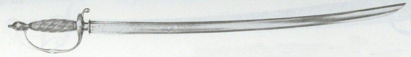

We don't usually think of the hanger as having a "basket-hilt" , but these examples from George Neumann's book,
"Swords & Blades of the American Revolution", show us that some indeed did !
( the English association aside ;-) Can't ya just see me with one of these , Scott *g* Mac

You don't really see these very often, I don't have any other examples to post other than the scans from Neumann which you have posted. I did however come across one at a arms show in Louisville last year. It was pretty neat.
Just as interesting are a few hangers with smallsword hilts, both of the "conventional" & loop-hilt form. One particular example is on pg. 100 of Harold L. Peterson's "The American Sword."

I forgot about this one. Not all hangers had curved blades, such as this basket-hilted example from Rod Akeroyd & Son.
Attachment: 57.61 KB
blade length- 21 1/2"

They look like Scottish broadswords with curved blades.

| Joe Harris wrote: | | They look like Scottish broadswords with curved blades. |
Indeed, Joe .... but unlike the claidheamh crom's , basket-hilts with curved blades (usually 31" inches or better ) these feature blades that are shorter , and hanger-ish !
