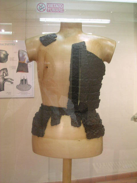

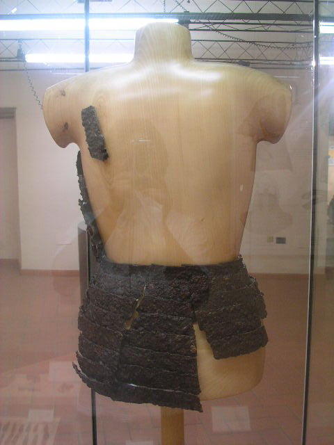

I hope that I do not derail this post, but here are two images of a suit that I have no providence for. My guesstimate is that it is 15th Century but wishful thinking and the bascinets in the background have me hoping they are late 14th Century. Does anyone have more information on this suit or clues where the information may be obtained?
Mackenzie
 Attachment: 41.84 KB
 Attachment: 41.66 KB
This is the damaged suit that has been put togeather in a way that is questioned by scholars - it comes from the Livorno area. It is usually considered to be late 14th century, but, sadly, the reconstruction is questionable.
