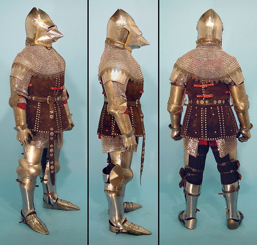

I just want some input on this type of body armour - otherwise know as a corrazina. I've been researching it alot lately, but haven't come up with a definitive (if there is such a thing) answer, so I'll put the question to the good folks here.
For the late 14th century (c. 1380-85), would the segmented globose have been made up of simply a breast and back plate, covered in cloth w/faulds, split up the middle and back à la brigandine, or made up of many different plates (particularly the back plates)? I'll attach images to show what I'm talking about.
The full back and breast would be easiest, of course, to make (I'm lazy, if you didnt already know), but I want to remain as close to historically accurate as possible, within budgetary and safety constraints. Keep in mind I'm already fairly certain that the plate faulds (more like tassets, actually) aren't correct - correct me if I'm wrong - so I'd go with the horizontal lames.
Cheers!

Hi Jason,
That type of armor, which has come to be known as corrazina on the internet (a term with no valid basis I've been able to find) is perfectly authentic for the latter quarter of the 14th century.
The two examples you showed a figure of were built by a man named Chris Gilman of North Hollywood, California, and those pictures came off of his company's web page.
The one that's split up the front is copied from a velvet-covered globose-breasted coat of plates in the Met in NYC. The piece is a nightmare of innacuracy because it was assembled by a man named Bashford Dean (a paleontologist by trade!) from bits and pieces of armor, and even random plates, he found in a treasure trove in Chalcis. You're right when you say the fauld is innacurate: It should have a hoop fauld much like the solid breastplate version (except split). The harness is probably northern Italian.
I don't know of many good examples of what this breastplate should look like, but my friend Will McLean had a copy many years ago made by Robert MacPherson, one of or perhaps the premier armorer in the world. Here's an unfortunately not so great picture of Will in his armor from that time:

Indeed, it would seem to be split up the back. Another feature I had never noticed before - at least until I saw Will with it on his breastplate was the little dip in the front of the fauld. And now, looking at the image you just posted, I see it clear as day. What's even more astonishing is that detail escaped me until now, and I've probably seen that image numerous times. You learn something every day! Thanks again, guys!

PostPosted: Mon 10 Sep, 2007 1:40 pm    Post subject:         Reply with quote
The dip shows quite nicely how the crotch was protected. I wondered always why the crotch was so open, while leg harness and hosen gave protection to the legs and upper armour to the rest of the body, this area only had braies and little padding with maille. On the other hand while sitting on the horse the saddle would be enough to fulfill that task. Bat while fighting on foot? Eek!
Hugh Knight
Location: San Bernardino, CA
Joined: 26 Jan 2004
Reading list: 34 books
Posts: 739
PostPosted: Mon 10 Sep, 2007 2:29 pm    Post subject:         Reply with quote
Well, remember that these sorts of things are fairly uncommon and only show up for a relatively short period of time. Most armor didn't cover the groin this way.
Regards,
Hugh
www.schlachtschule.org
Felix R.
Location: Germany
Joined: 08 Oct 2006
Reading list: 25 books
Posts: 555
PostPosted: Mon 10 Sep, 2007 3:01 pm    Post subject:         Reply with quote
But is this uncovered groin more or less mostly associated with horsemens armour?
Hugh Knight
Joined: 26 Jan 2004
Posts: 739
PostPosted: Mon 10 Sep, 2007 3:34 pm    Post subject:         Reply with quote
It's not associated with either. Most 15th-century harnesses didn't have a different breastplate for fighting on foot or horseback. You might change the pauldrons or helmet, but the breastplate (and fauld) was the same.
For example, look at this picture from the Paulus Kal Fechtbuch:
http://mdz10.bib-bvb.de/~db/bsb00001840/image...p;seite=15
This is his mounted harness, he's about to get on his horse.
Compare that with this picture from the same Fechtbuch:
http://mdz10.bib-bvb.de/~db/bsb00001840/image...p;seite=44
He's now fighting on foot, yet you can see that the same cutout exists in the front of the fauld.
Then here you see a harness for a fight that *started* on foot (since it's with pollaxes), and the harness still has a cut out over the groin:
http://mdz10.bib-bvb.de/~db/bsb00001840/image...p;seite=84
Here's another example of a harness for a fight that starts on foot, and still the groin is uncovered:
http://base.kb.dk/pls/hsk_web/hsk_vis.side?p_...p_lang=eng
The English during the Wars of the Roses tended to favor harnesses with longer faulds than were seen on the continent, much like the one in the picture I sent but without the "dip". Note, however, that these were the same harnesses used for riding:
http://www.mbs-brasses.co.uk/pic_lib/Chalfont_St_Peter_Brass.htm
Now, there *were* some armors that covered the groin after the period we were discussing that were used for foot combat, such as this one:
http://sl-armours.com/patterns/henryviii_1514_tonlet_harness.jpg
But such armors were for specialized friendly combats (and 16th-century, too!).
Regards,
Hugh
