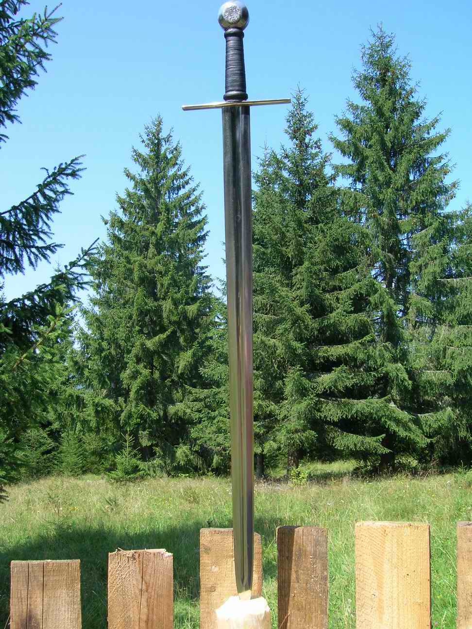

PostPosted: Tue 24 Aug, 2010 12:42 am    Post subject:         Reply with quote

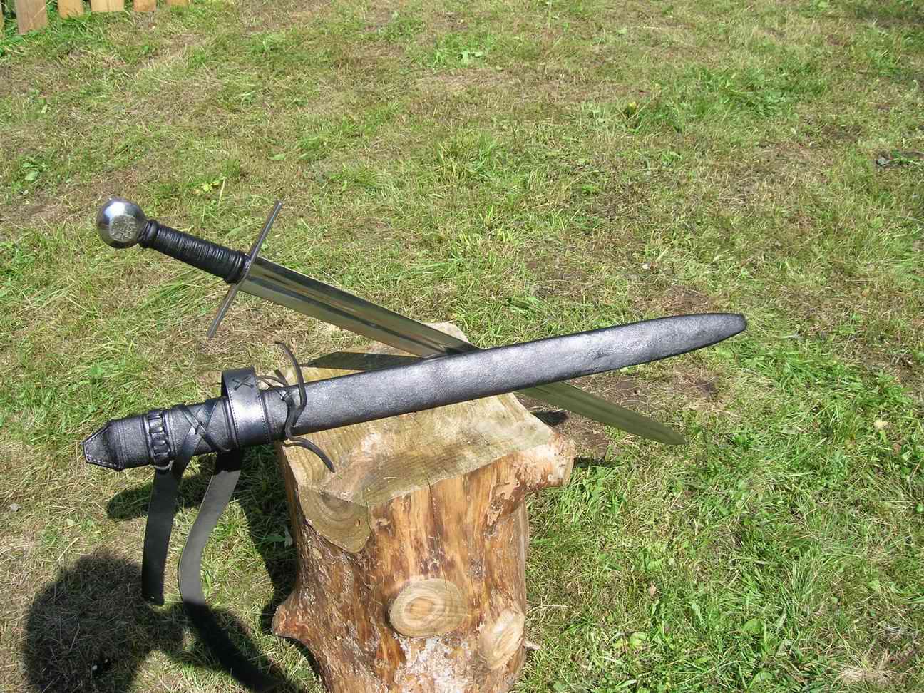

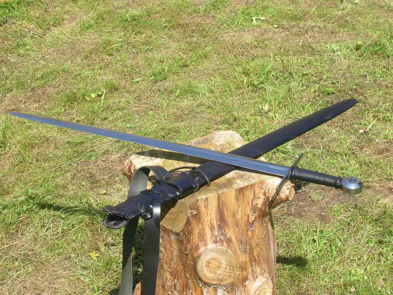

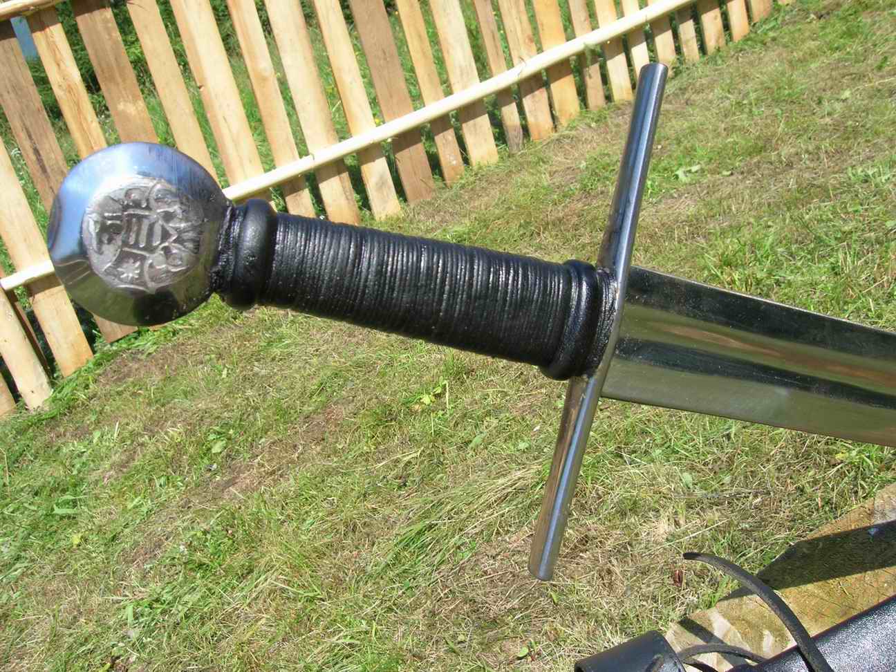

Here's my "Raven":
Total length 97 cm
Blade length 80 cm
Grip length 11,5 cm
Blade with at base 44 mm
Blade thickness 7 mm tapering to 3.5 mm
CoG 12 cm from guard
CoP 54 cm from guaRD
Weight 1,2 kg
It needs some finishing touches, but I couldn't wait...
 Attachment: 241.48 KB
 Attachment: 186.43 KB
 Attachment: 175.97 KB
 Attachment: 82.01 KB
 Attachment: 226.6 KB

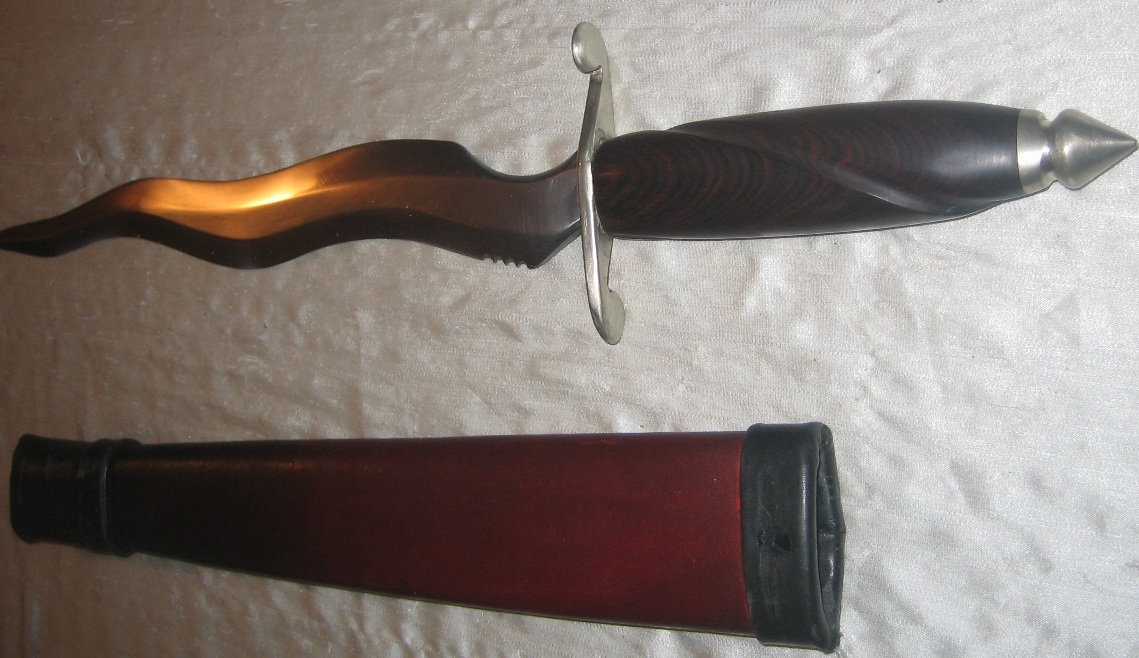

PostPosted: Sun 20 Feb, 2011 7:06 pm    Post subject:         Reply with quote
HI all thought I'd throw my two coppers in.
 Attachment: 247.29 KB
my take on a keris. [ Download ]

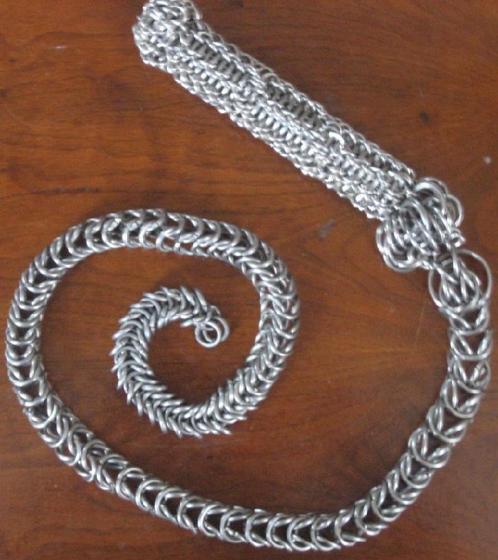

just a chainmail whip [ Download ]
 Attachment: 96.61 KB

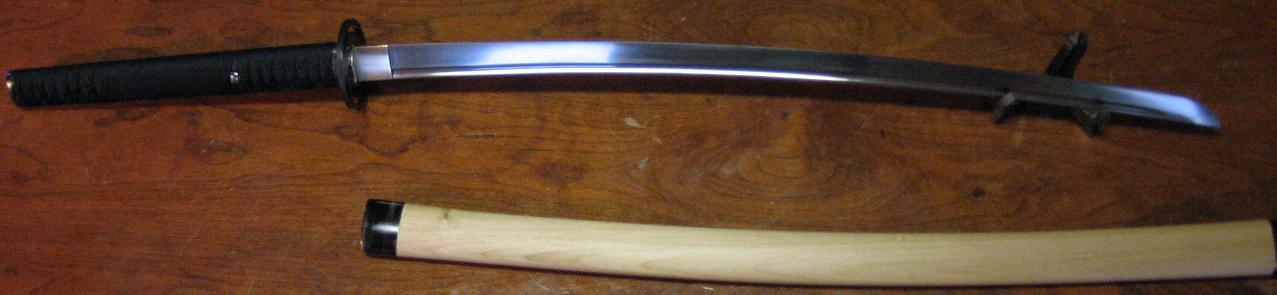

tsuba and habaki of the katana I did [ Download ]
 Attachment: 102.93 KB
the kissaki [ Download ]
 Attachment: 52.03 KB
the whole thing [ Download ]

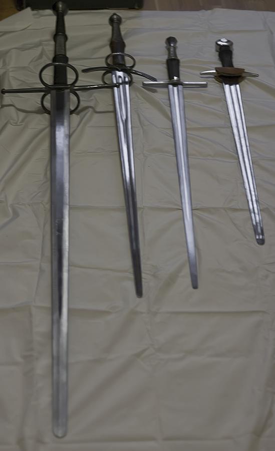

PostPosted: Fri 18 Mar, 2011 1:16 pm    Post subject:         Reply with quote
Finally got a friend of mine take pictures of my arms and armor. There are a lot of them, but for now I will post photos of hilts that I have made. Blades are:
- Hanwei medieval practical
- Hanwei Tinker line bastard sword (blunt)
- Hanwei practical longsword
- Two-handed gothic sword by Jiri Krondak
The smaller swords are well-balanced and agile training weapons, I am very satisfied with all of them. The two-handed one is 155 cm long monster that weighs almost 3 kg. Definitely not the fastest weapon out there, especially for a small guy like met though the weight itself is perfectly OK for a sword of that length. I am thinking of regrinding the blade and modifying the pommel to make the sword lighter.

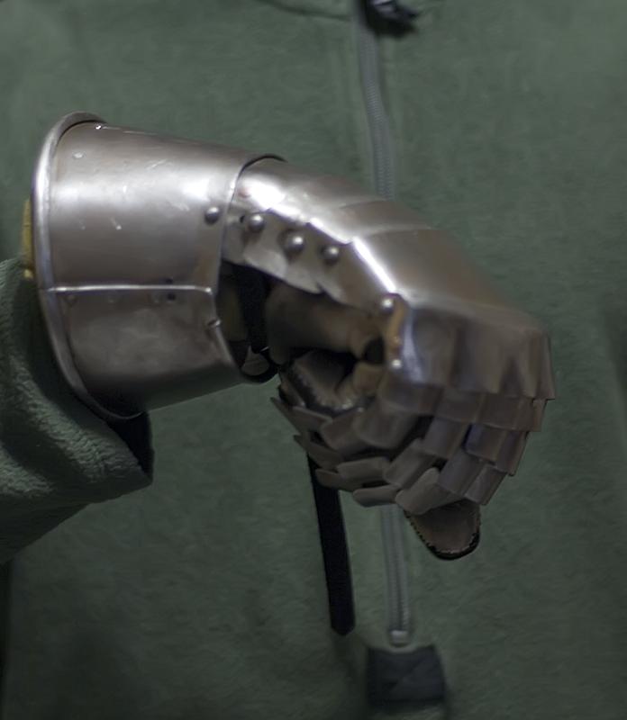

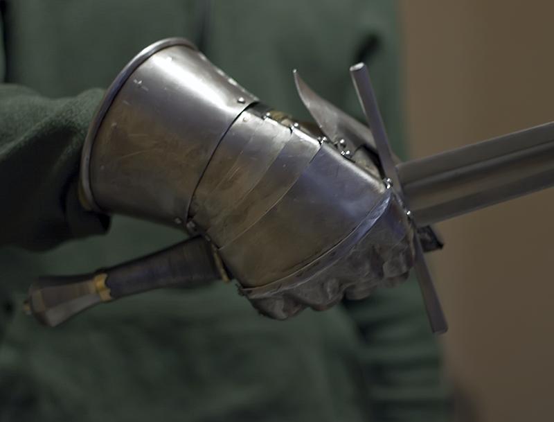

PostPosted: Mon 21 Mar, 2011 6:12 am    Post subject:         Reply with quote

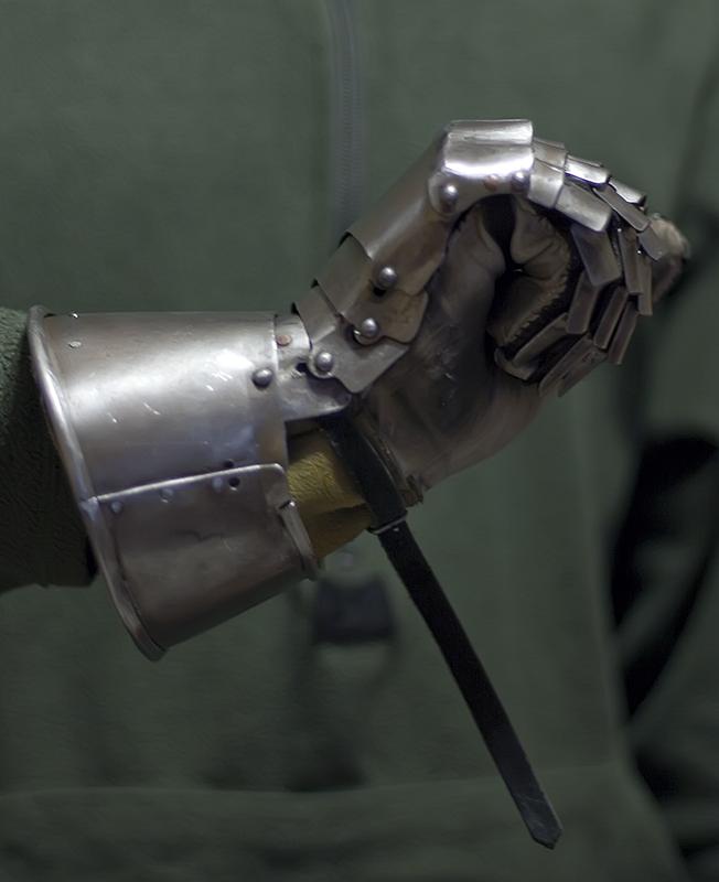

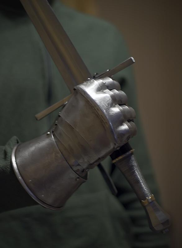

The second post on my self-made stuff. A fingered gauntlet made just for the fun of it. Offers little protection since there in virtually no padding, but does not restrict movement at all. Good for light practice where you do not expect to get hit but can still catch an occasional blow. On the photos I bend my hand as much as I can. I could bend it more if I did not clench my fist, the gauntlet permits more movement.
You might notice that I was not trying to replicate any particular style. All my armor so far has been optimized for performance since first of all I fight in it and modern reenactment/WMA is in many aspects different from medieval tourney or battlefield and second I still have a long way to go to consider myself a master armorer so I try to make many different objects using different techniques rather then make a faithful replica of a single one.
Any comments are welcome, especially technical advices on how to make next gauntlet better.

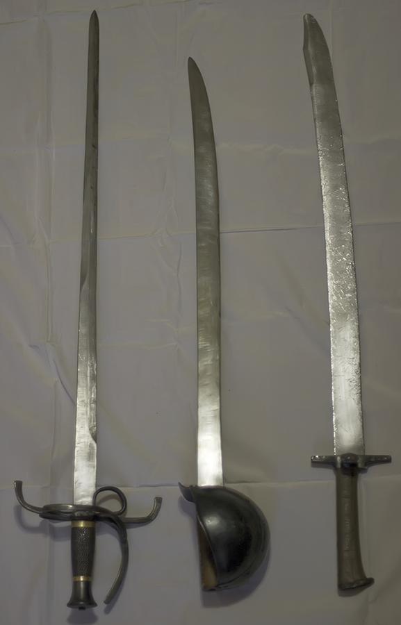

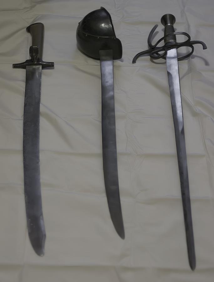

PostPosted: Mon 28 Mar, 2011 4:48 am    Post subject:         Reply with quote
Some more blades, this time entirely self-made. Cutlass and cut-and-thrust sword are sharp, messer is a blunt. Unfortunately neither of these can be called very good since
- cut-and-thrust has no distal taper. While it is light, has a good balance and can deliver a pretty nasty cut, it would be much better if the blade was thinner and wider at the point. Or, if it had a longer blade, it could become a good rapier. Unfortunately my possibilities were limited by the size and shape of steel I had (this blade was made by stock removal).
- cutlass has too little distal taper and therefore is rather heavy for its size. The blade was also made by stock removal.
- messer is point-heavy and overall weight of around 1.2 kg is probably too much for such weapon. But it was intended to be that way from the very beginning because I needed a relatively short blade that could deliver a powerful cut to use as a side arm in reenactment events when my primary weapon is something two-handed. All metal parts were forged.
