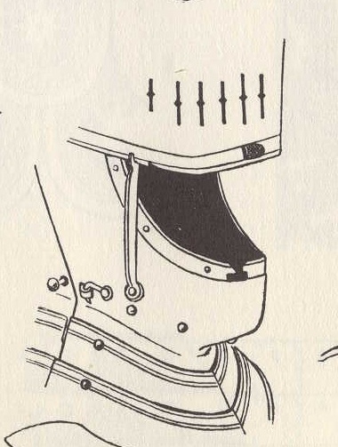

Do you have any pics of those 'arms'?
Yes, here's a picture from an armet. This is from Blair, p. 227.
 Attachment: 72.83 KB
