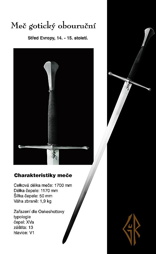

I am currently searching for a good sharp for test-cutting. Dose sword-gur offer sharpened swords, or just blunts for sparring?
 Attachment: 16.89 KB
The Sword I am planning on getting: model J007
 Attachment: 41.76 KB
The sword my friend is planning on getting: model T001 [ Download ]

I hear from Schola Gladiatoria's forum that you can get those swords sharpened for an extra 10 euros. But remember that it won't produce a sharp sword, just a sharpened blunt. If you know what I mean.
