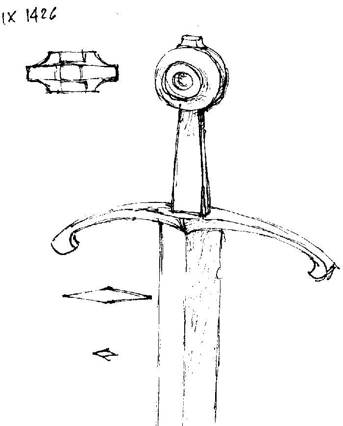

Here is a quick sketch I did a few years back when visiting Royal Armouries in Leeds.
The data I have on this sword is from the museum:
Inventory number IX.1426
Overall length: 94 cm
Blade length: 77.5 cm
Weight: 1300 grams
The blade is of strong diamond section. Flat bevels or very, very shallow hollow ground.
Note that the guard looks narrow from the front, but is of ribbon type: pretty wide. The ends are nicely forged into thickened "scrolls".
I would guess the point of balance to be around 10 cm from the guard (a guess!).
Hope this helps.
This is a *very* nice sword! Cool
 Attachment: 58 KB
